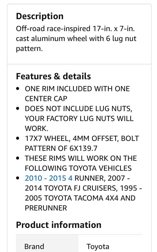

    Yeah Aldo..the TRD Pros are 17s.. but if you look at the size diff in the Pro and the Sport wheel there is a little diff.. I didn’t know if that mattered? I guess as long as the tire is a 17 as well as the new wheel..hate not to use such a good tire. With low miles
  10. Jun 23, 2019 at 7:59 AM
    Tacodan
    Tacodan [OP] Well-Known Member
    Mar 30, 2011
    #54025
    234
    NC
    05 tacoma sport
    Here’s the description
  11. Jun 23, 2019 at 8:08 AM
    Aldo98229
    Aldo98229 Well-Known Member
    Apr 13, 2019
    #290072
    1,440
    Aldo
    Bellingham, Washington
    2019 Tacoma TRD Off-Road
    Yeah that sounds like the 4Runner SEMA wheels.
    They should fit.

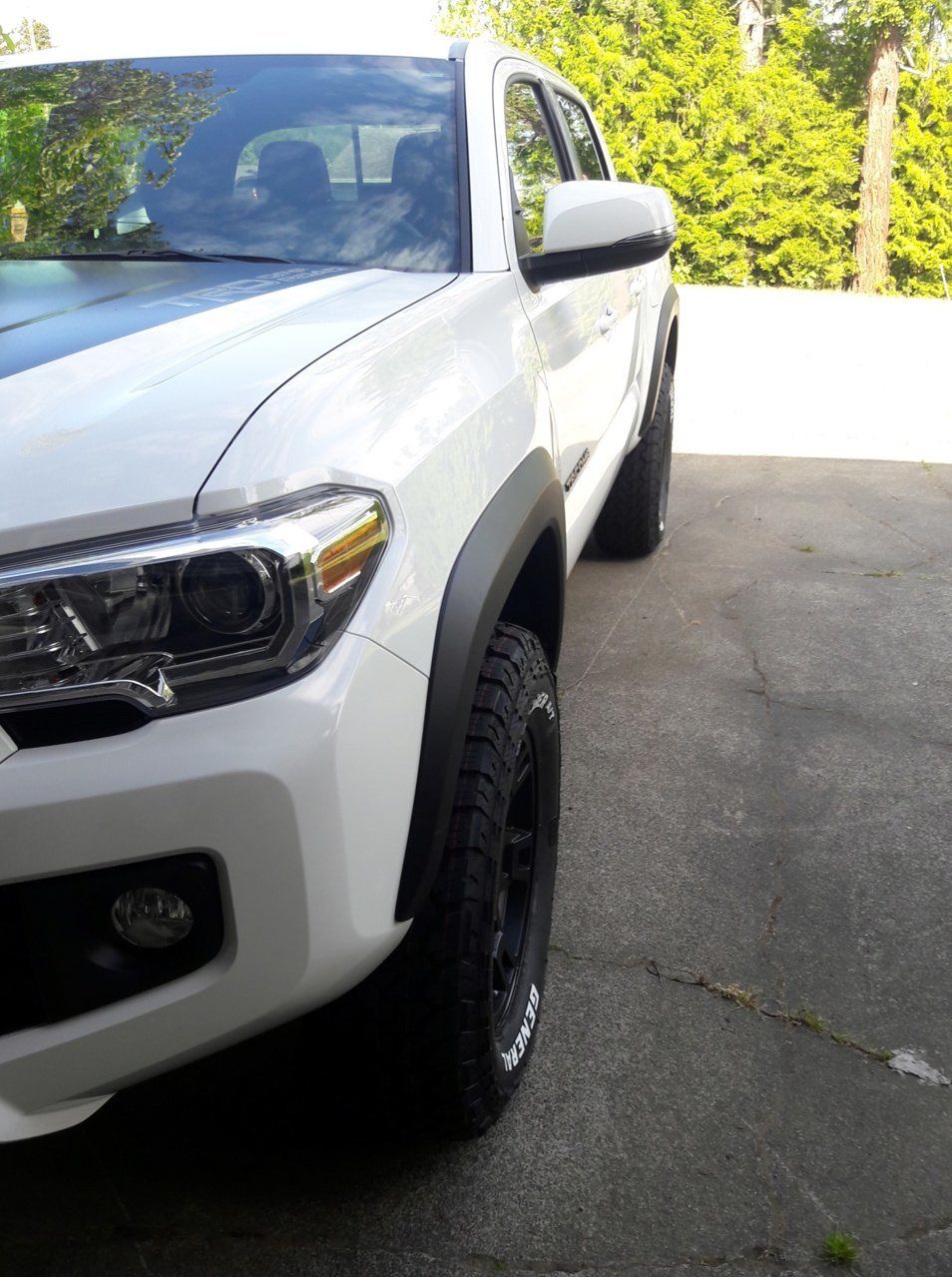

  13. Jun 23, 2019 at 8:17 AM
    Aldo98229
    Apr 13, 2019
    #290072
    1,440
    Aldo
    FWIW, I just got a set of 17x7 SEMA replica wheels and 265/70-17 General ATX tires: discount tire mounted them without blinking an eye. They are normally sticklers about mounting tires on wheels that aren’t wide enough.
    61711552_10156727683402600_8703418747630_c1acc874a141cf2f77f403d8dda8ec87f64f8b1e.jpg
    60892733_10156708269962600_2023726321439_7c4f8f2b8ab4c3894ab759286202f55cf10de835.jpg
    Tacodan[OP] and DavesTaco68 like this.
