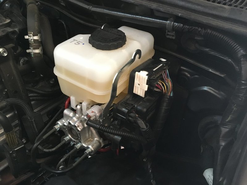

    This photo is of my Sport...the MC is a totally different set up to the OR.
    Why not purchase the OR if the intent was to have locker/crawl control?

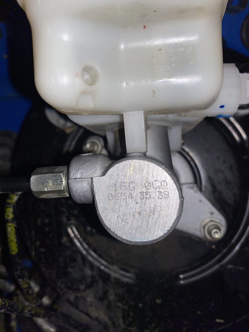

    My sport model has this master cylinder.
    Is OR different?
  17. Jan 2, 2023 at 7:15 PM
    #37
    crazysccrmd
    crazysccrmd Well-Known Member
    Mar 17, 2016
    #181592
    9,240
    Alaska
    Aprilia Tuareg 660
    Completely different. This is an off-road master cylinder, they are not interchangeable without a fair amount of work to change it and the ABS system.
  18. Jan 2, 2023 at 7:17 PM
    #38
    Bishop84
    Bishop84 Well-Known Member
    Dec 17, 2015
    #172494
    11,979
    The booster alone usually goes for over 2000$, on top of the wiring harness and brake line requirements.
    Shy of a full donor truck, this is likely not feasible.

  19. Jan 2, 2023 at 7:23 PM
    #39
    Rainoffire
    Rainoffire Well-Known Member
    May 31, 2018
    #255034
    3,106
    2017 QS DCLB TRD Sport
    Very different
