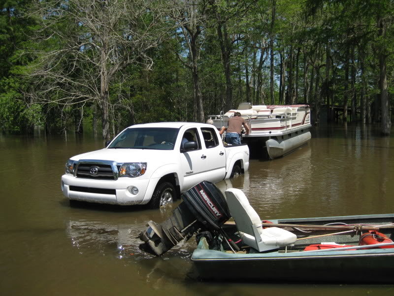

    Hi David, we have a mile and a half trail on some hunting property that is an old, washed out clay and black mud logging road. It'll crawl it in A-Trac, but if the trail is in bad shape, you can smell the brakes after the system has been kicking on and off for half a mile. I just engage the locker and poke along. Seems a lot let stressful on the whole system. I do have a pic of the one time A-Trac just would not cut it, and I absolutley had to use the locker. The rear drums just could not hold the spinning wheel after they got soaked. It made a god-awful racket trying, though!

    Thanks fishshooter, you may have seen that I am trying to have the best understanding of our traction devices, so your input is appreciated! Most of my four wheeling in on dry land, desert, and beaches in Baja. The big exception was the 3 foot deep bog going to Mision Santa Maria, last May! I now have the differential breather up high so no more contaminating the gear oil with mud and water (I hope you have alos extended your breather based on what I see above!).
    The A-TRAC does make a lot of noise pulsating the brakes, but I think I now see that (in your case and others) if there is a prolonged underwater run or a long slippery mud road... just lock the rear, and also have A-TRAC on so if you start to get stuck, and speed drops to 3 mph or less, the A-TRAC will turn the front end into a locker and pull you on out!

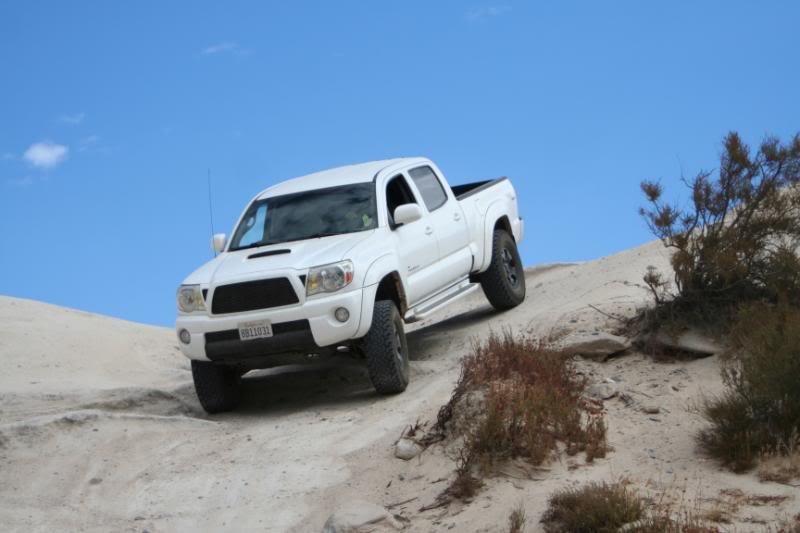

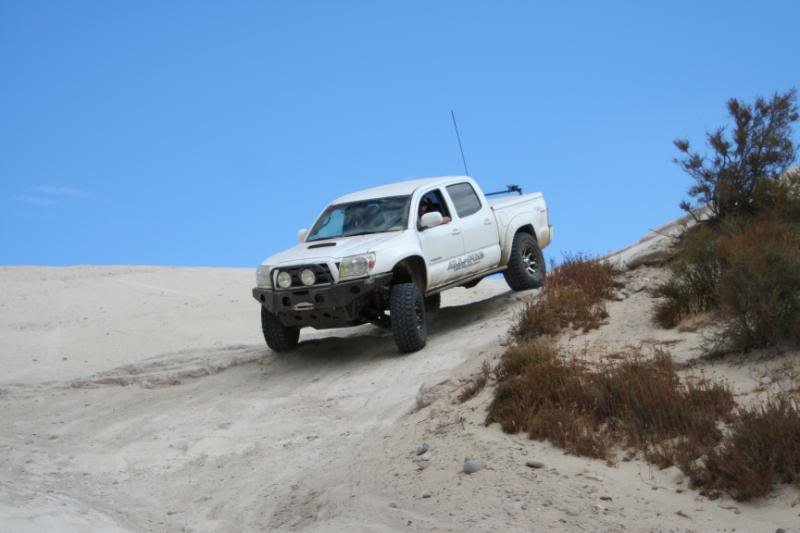

    Exactly, I mean look at these TRD SPORT Tacomas on this hill. They're about to crash at this extremely critical moment, all because of that damn hood scoop!

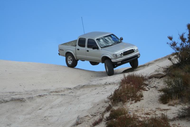

    Then look at this TRD OFFROAD, I mean if he would've had a hood scoop he would've surely rolled his truck!
    Where's the rolling eyes icon when you need it...
