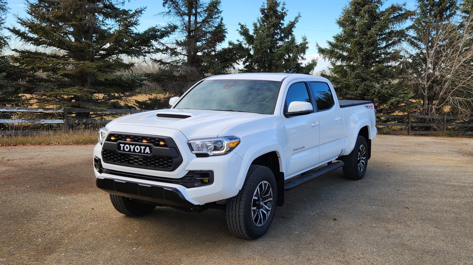

    Who's running a 3rd gen TRD Sport with 17x9 wheels with a +1 or 0 offset in 265/70r17 tires?
    From my research it appears the Sport has the lowest stock ride height. Curious what others have done to run that size wheel set up without any rubs or the need to trim anything.

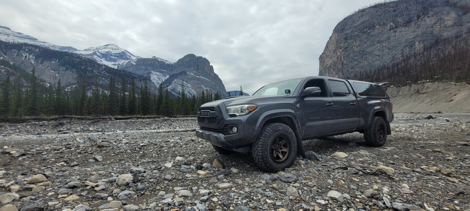

    17x9 +1 with a 265/70r17 duratrac. I removed the chin strap and put on rokblokz mud flaps and I had virtually no rubbing. Honestly miss that set up.

    It was so minor I never chased it. It was only on trail runs so could of just been built up mud when it happened.
