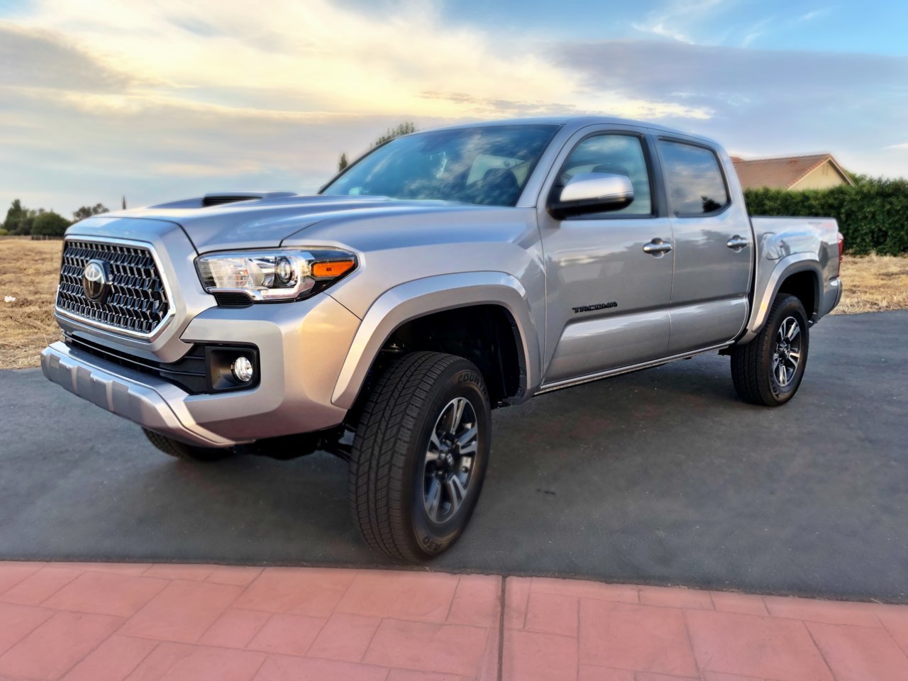

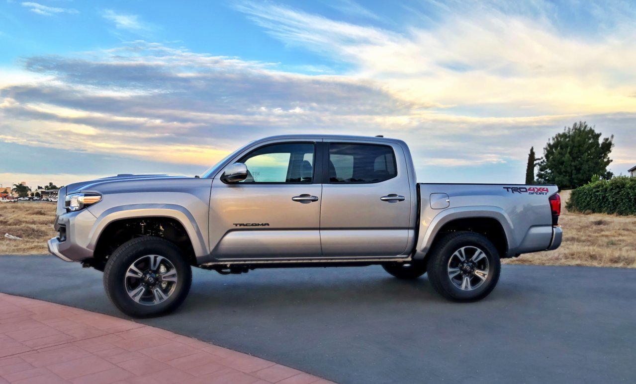

    2018 SPORT....In love with this pretty lady

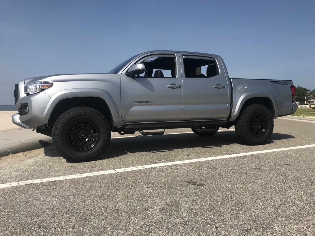

    Sorry folks, I forgot to post my first photo of my new Sport here. This photo session was last Saturday, 30JUN, just two days after taking him home. I wanted to document what he looked like in all stock form... So far, nerf bars have been added, the 1/4 panel stickers have been replaced, sealant put on, and a few other small odds and ends.

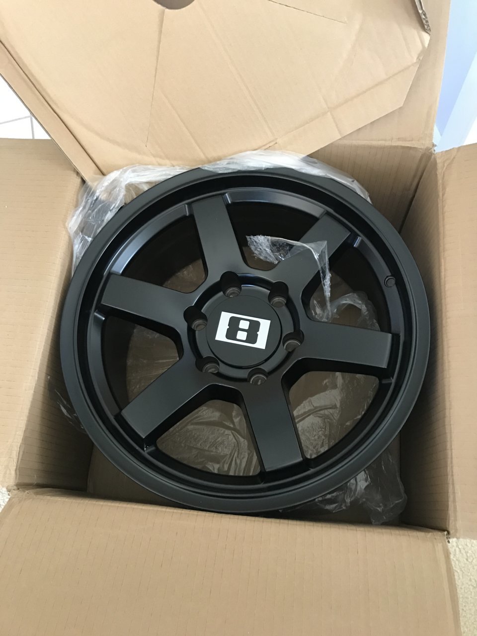

    1.55" front lift with 1/4" spacer on driver side. 1" tapered block in the rear, but looking into single AALs and progressive e 3 pack AALs options.
    Level 8 black MK6s are slowly arriving...one at a time. 265/70/17 KO2s on the way, Samsclub blowing balls with slow delivery to store. Haha
    Hopefully will have rims and tires mounted and aligned then I will consider the AAL.

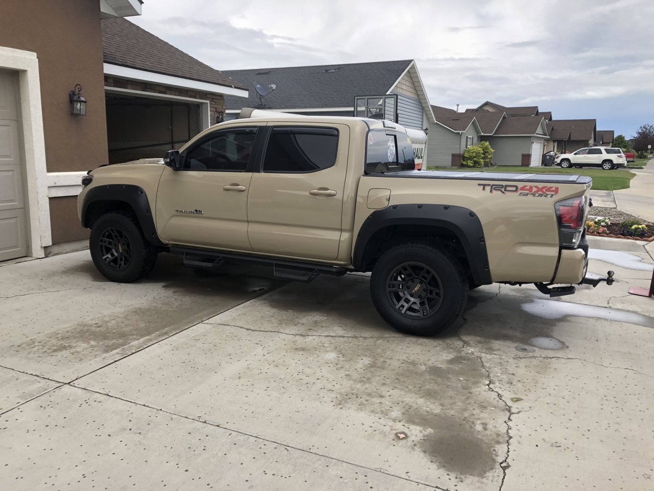

    Ultra Flex bed cover, TRD PRO Grille, 32" LED light under grille, Pop n' Lock on tailgate, OCD organizer for center console and glove box, LED bed lights, OEM bed mat, black TACOMA tailgate letters, LED illumination light package, black vinyl overlays for badges, OEM bed step, plasti-dipped front valance and mirrors, 15% tinted windows and sun strip, vinyl letters on dash, vinyl letters on tailgate handle and door sill protectors, TRD Pro shift knob, home-link rear view mirror, mountain vinyl decal above Tacoma on door, FN FX pro wheels, AVS bug deflector, AVS in-channel window vents, front bed rail, red line hood struts, LED interior lights, TRD Pro skid plate, slim line front license plate holder, CaliRaised LED Ditch light brackets with LED lights, Bilstein 5100's, OME 888's, Dakar HD leaf springs, cubby covers, CaliRaised LED Fog light kit,
    No lift yet, working on that but it's slowly getting to look like I want it. Once I add the lift, will be changing out rubber's.

    Aw Man! That's one sweet Tacoma! I just got a 4x4 Sport too, I gotta know what you did to yours... lift, tires/wheels... share man!!!

    Hey, what size wheels are those (width)? That stance is aggressive! How do the Falkens drive on roads and highways?

    they are 17x8 0 offset
    the falcons are very quiet on road, i have the SL rated
