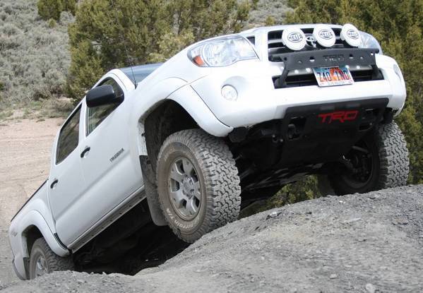

    Learn from my mistake don’t use regular black spray paint, it chips and looks like crap after a month. I did that and ended up scraping it all off and spraying it again with 3M rubberized undercoating. Since then I have not had any problems with it chipping.
    First step is to spray the plate with quality undercoating. 3M rubberized undercoating worked great for me and I picked it up at AutoZone. Once the plate is dry you are ready for the TRD logo if you chose to put one on it.
    The TRD logo is easy all you need to do is take a TRD logo you find on line like the one below paste it into Excel (you could use other programs but Excel works good and easy) and stretch it the desired size and print. I printed off a couple different sizes just to make sure to get the size I wanted. Next cut out the TRD log out and carefully tape around each letter leaving the exposed plate bare for painting. Take your time on this step don’t rush otherwise it will it won’t turn out right. Once you are ready to paint the TRD logo tape off the rest of the plate to avoid overspray.
