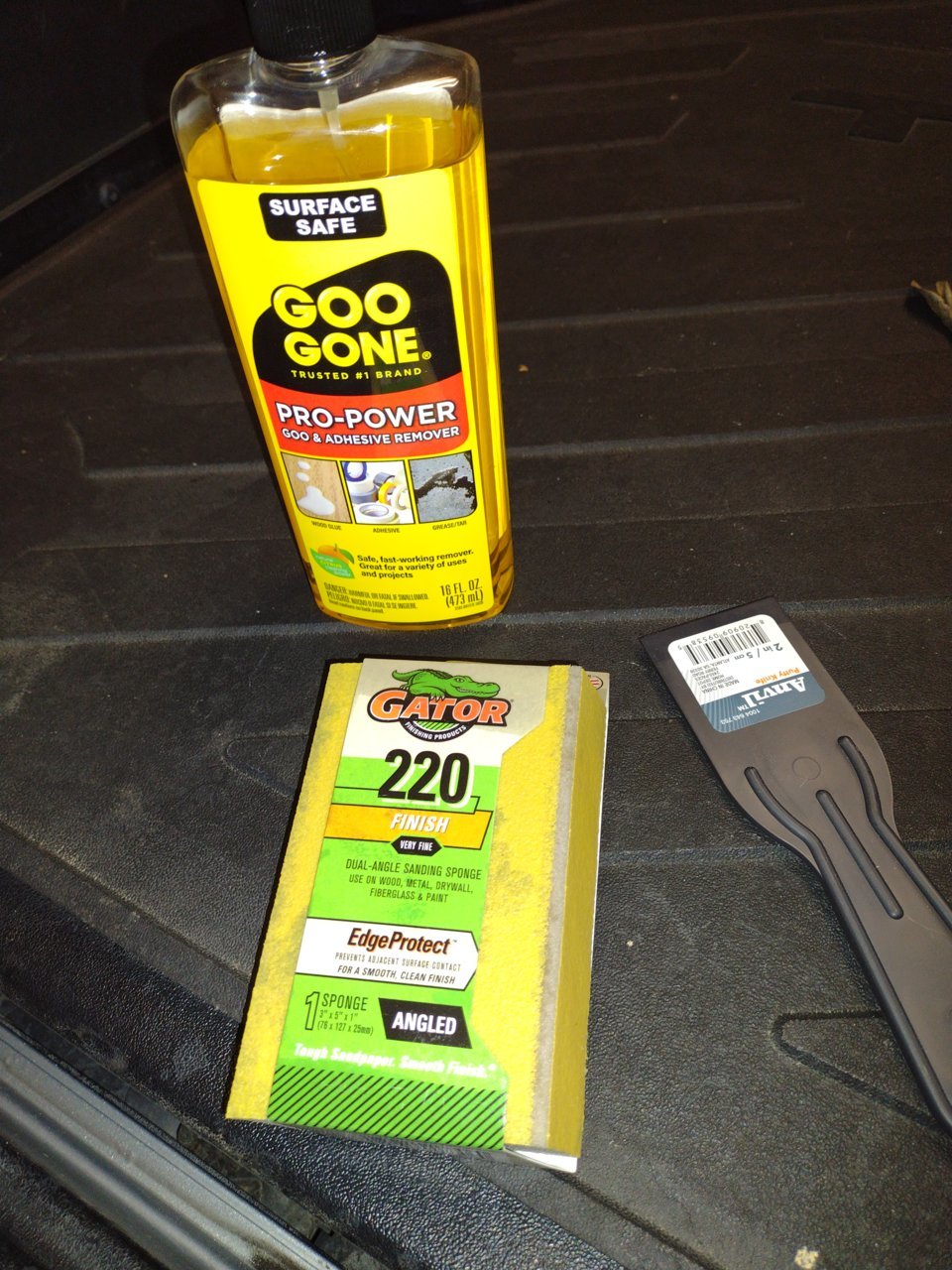

    Thanks everyone, this is what I got and it's doing the job nicely ( just going slowly)IMG_20230819_101353651.jpg

    It's a 2017. Got the glue off but still see some shadowing of sticker. Hopefully some cleaner/wax will take care of it

    I haven't solved the shadowing problem yet
