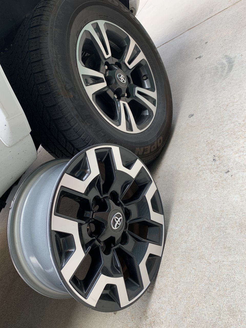

    I got some TRD off-road wheels to put on my TRD sport for winter. Is the ride height the same as the off-road. Does it matter? I was going to get bfg ko2 265/70r16 or comparable.
    Thx

    If your sport tires are still stock size, those tires you chose for the 16s will be the same outer diameter, which means they won't affect ride height.

    Right. 265. The next number represents aspect ratio% that’s why the number is higher with the smaller rim. Unless I’m wrong isn’t there a 265/70 and a 265/75r16? Is that just a wider tire with same diameter? Does that mean anything above a 265 diameter will Rub?

    265mm is the width, not the diameter.
    75 is taller(greater diameter) than 70.
    265/75-16 will fit without a lift.

    I think you meant 265mm width not diameter. In any case, I don’t think there are wider options than 265mm in the same diameter. There are a ton of threads on here about tire and wheel fitment. Try searching with your favorite search engine. The general consensus is that the tallest tire you can run without modifying your truck is 255/85r16 (or r17 equivalent). I’ve never really researched it, but I suspect that the widest is 265/70r16 or 265/75r16.

    I think I misunderstood your question the first time. Your use of the term "ride height" confused me because it seems irrelevant. If you are asking if 265/70r16 tires with the TRD off-road 16" wheels will work on your Sport, the answer is yes; albeit I have never done that myself. I have a set of 16" TRD off-road wheels and a set of TRD Pro wheels for my 2020 TRD off-road. I believe the Pro wheels have a slightly different offset but are otherwise compatible.
    EDIT: have you considered a dedicated winter tire instead of an all-terrain? That's the way I would go for a summer/winter on-road set up. I currently have an off-road/on-road set up, so I will likely be running the stock all-terrains this winter.

    By ride height I meant distance from hub to fender when suspension is loaded. I was thinking there was some extra room in there which explains why the 75 fits. You answered the question I just understood the tire markings incorrectly. Yes I plan to put 265/75r16 tire on those OR wheels for winter use. The reason I wanted to get something like a ko2 was for durability I live in Denver and I think I would melt off a nice blizzak snow tire on warm dry pavement. We have days like that throughout winter out here. Totally open to suggestions. I just don’t want to slip my way through winter again on these open country tires. Thx

    265/70R17s and 265/75R16s will fit without rubbing. There are also 255/80R16s (pizza cutters / need confirmation as that might be 255/80R17?) also. That's a full 33in.
    It isn't the hub to fender that matters. It hub to the rear side of the wheel well. Larger tires will rub the plastic liner, body pinch weld, or cab mount at certain steering angles and suspension movement.
