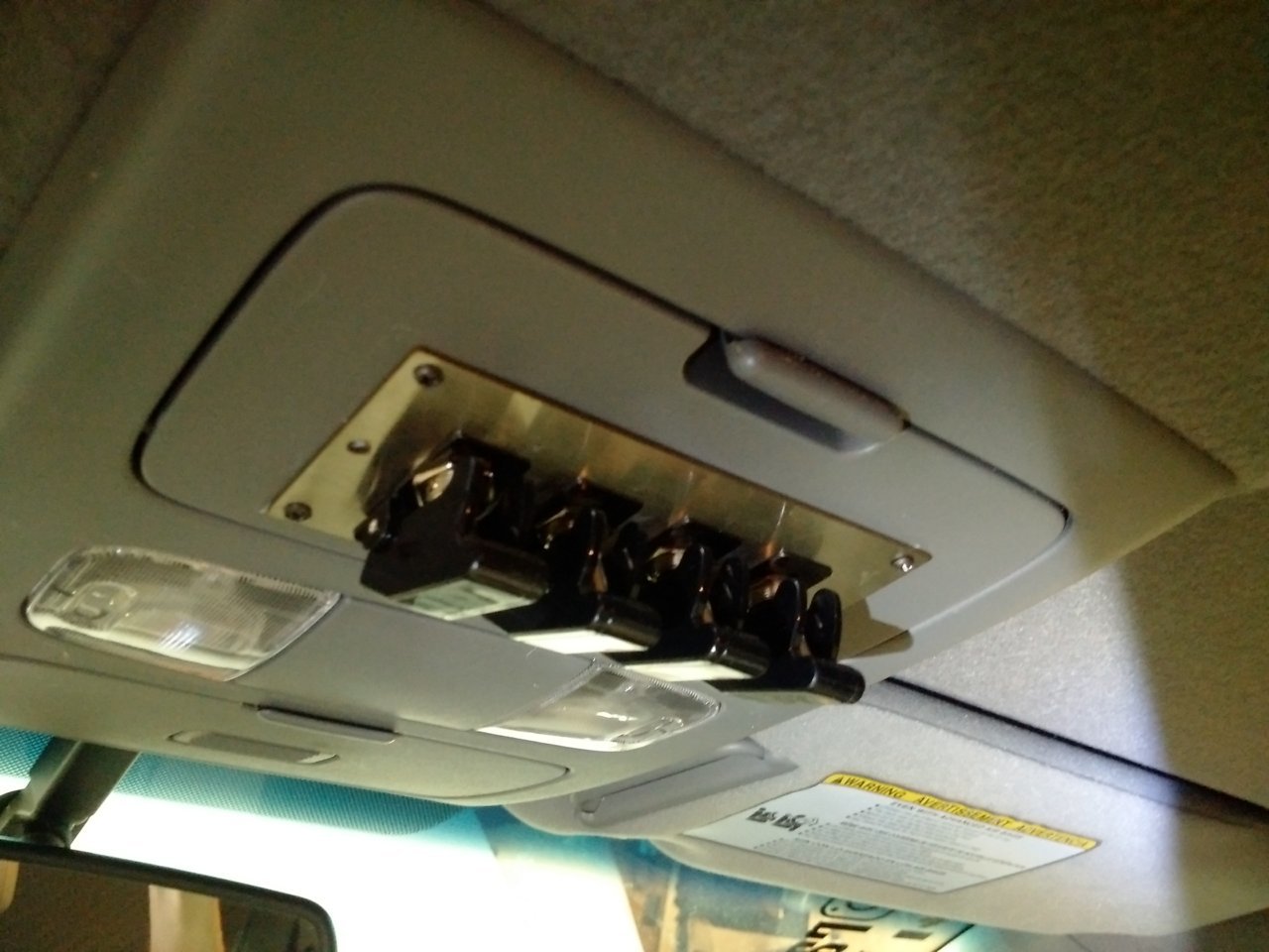

    Actually the switches are a bit inane. Glovebox heater, toolbox heater, and momentary switch for water meth transfer pump. The fourth switch will probably be the hand throttle, which is a little more interesting.

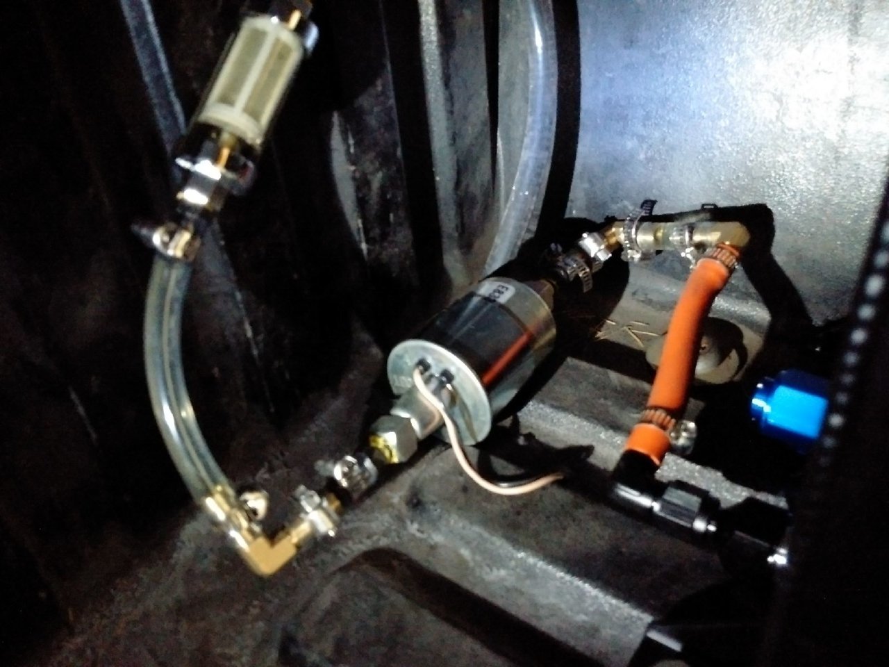

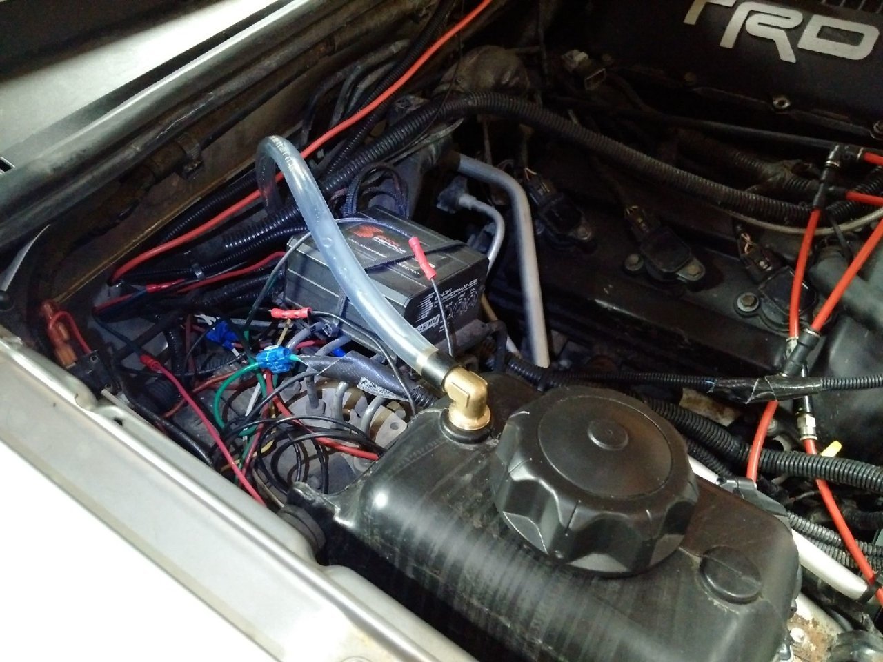

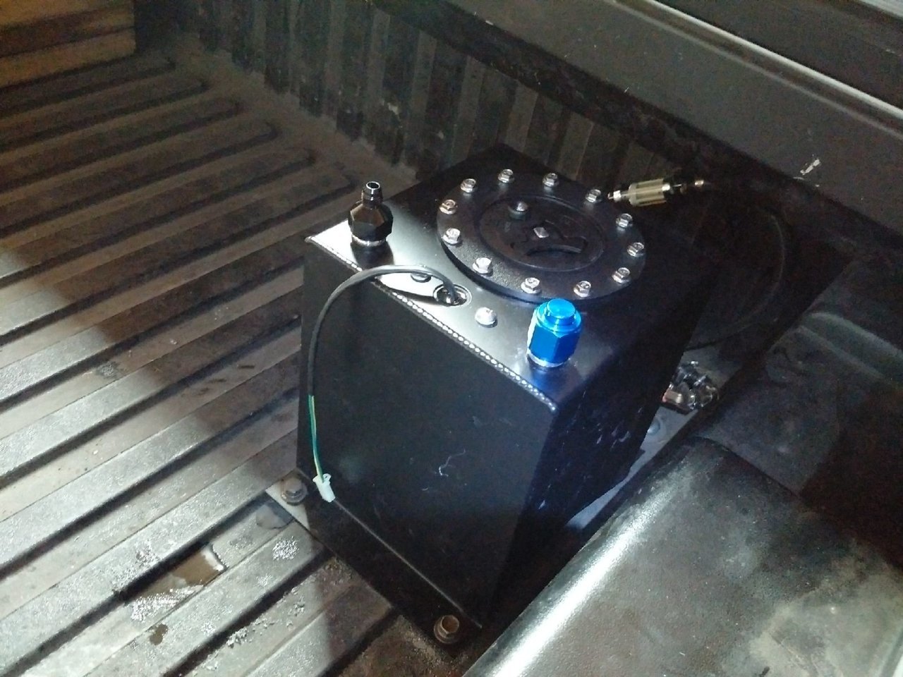

    Newest weird-ass mod. I installed a water/methanol reserve tank in the bed. Why, you might ask? Because now that I run 900ml/min, on a stint of very spirited driving or on a long highway drive, the engine bay reservoir is drained quickly. This will allow me to refill the engine bay reservoir using one of my overhead switches - there is a small pump and a basic inline fuel filter in front of the tank.

    Mid flight re-fuel sounds like it would be satisfyingly fun to do!
    Question: is there a way to tell when the main reservoir is filled so you know to turn off the pump or does the pump turn on for a timed delivery? If you forget to toggle a manual on/off pump it could possibly get damaged trying to fill the full main reservoir.
    Athlaos[QUOTED][OP] likes this.
  17. Dec 22, 2020 at 7:13 PM
    #537
    Athlaos
    Athlaos [OP] Destruction Mode
    Nov 24, 2010
    #46672
    2,585
    Leigh
    Edmonton
    2011 SR5 Manual TRD SC 1.87" pulley
    A flux retro-capacitance encabulator
    Good question - I start to re-fill the engine bay reservoir using the cabin switch once the low-level indicator turns on, and basically just guess by counting in my head. But the switch used to pump the fluid is a momentary one, so I won't be able to leave it in the "on" position. The engine bay reservoir also has pressure relief in the cap in case I do overfill it a bit.

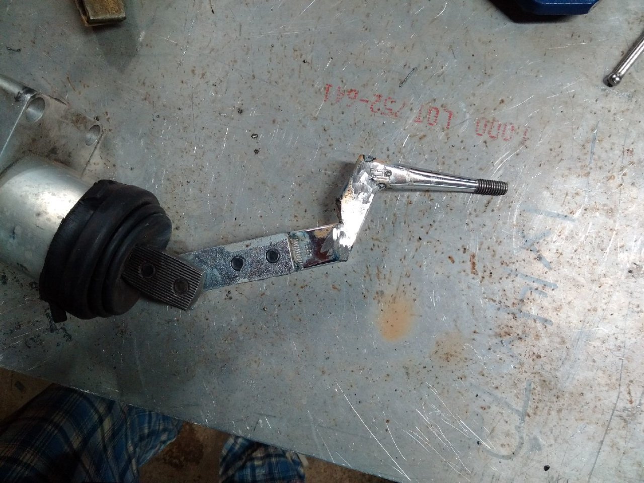

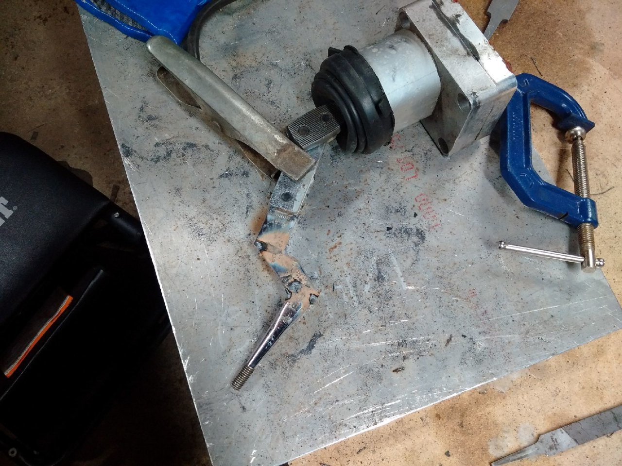

  20. Dec 23, 2020 at 6:44 PM
    #540
    Athlaos
    Nov 24, 2010
    #46672
    2,585
    Leigh
    Edmonton

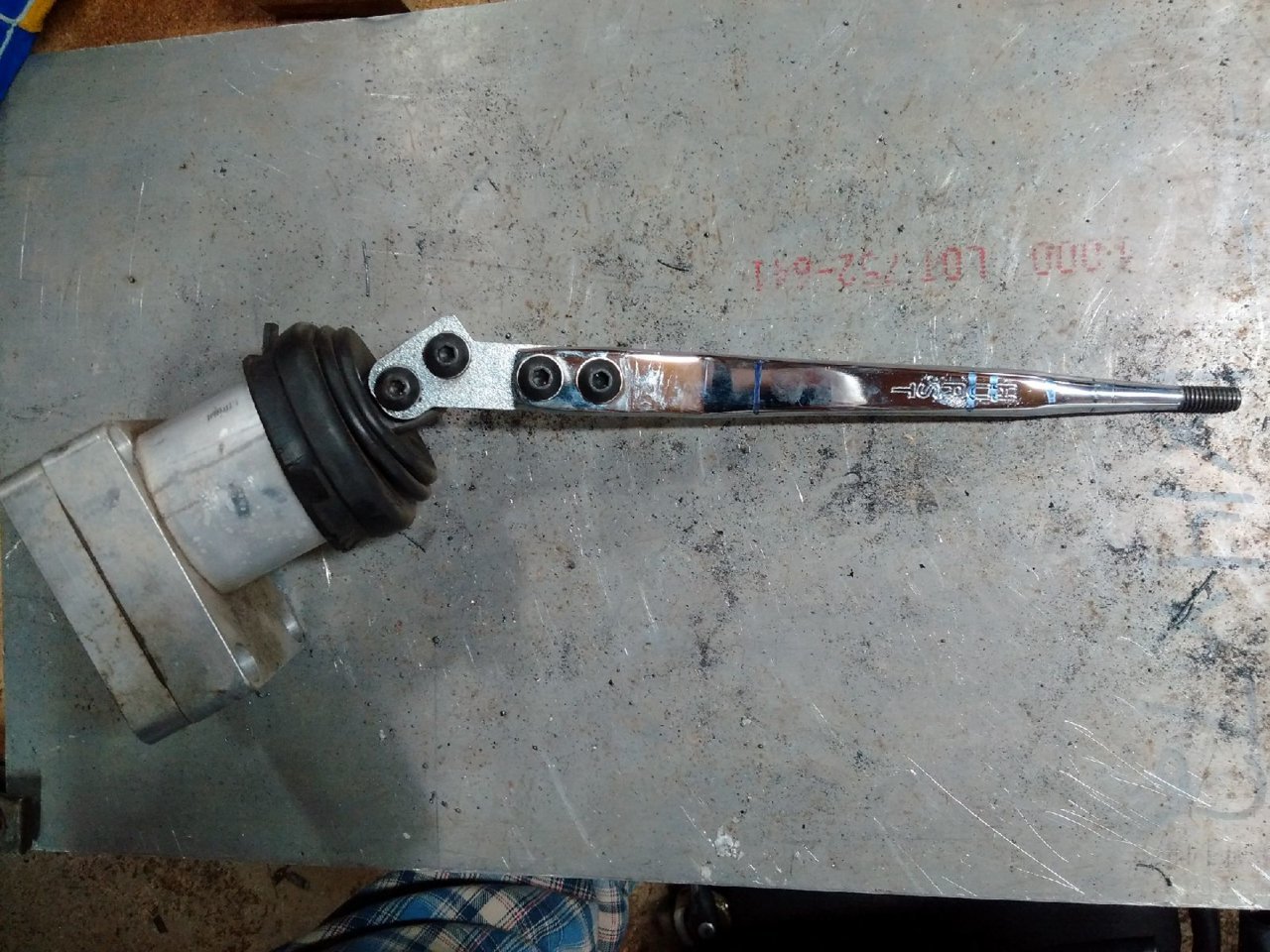

    Now that I can pretend to weld, projects are starting to come to me. I shortened my Hurst shifter, having a 5" long billet shift knob somewhat negated the short-ness of the shifter (even though it is also combined with URD short shifter). I also welded one of the shifter's joints because it would always come loose and lead to a sloppy feeling in the shifts. And yes, I'm fully aware of how bad the welds are. I tested them with a hammer so I might be good.
