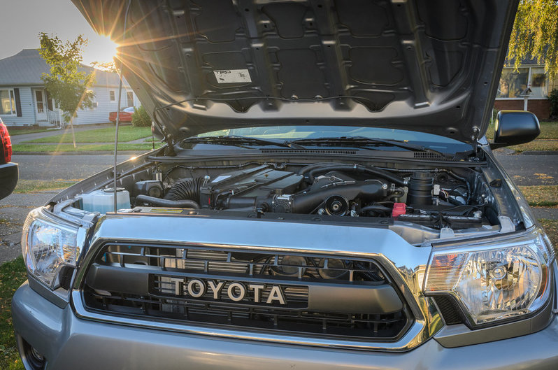

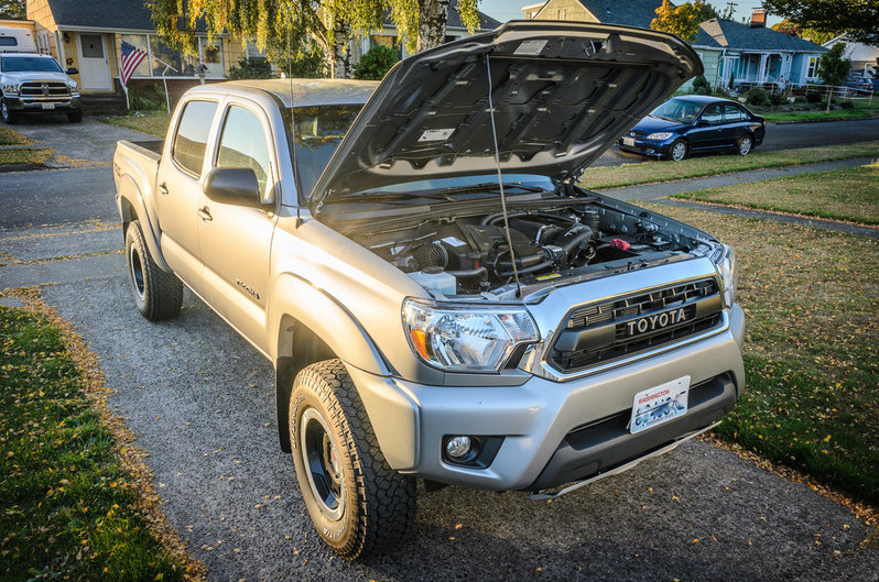

    TRD Supercharged, TRD Exhaust, TRD Bead Locks, OEM Audio +, Bilstein 6112's/5160's
    TrackAttack, TeamSarcasm and GT7 like this.

    #1557
    zeekevin
    zeekevin Well-Known Member
    Jan 5, 2012
    #70020
    1,884
    San Diego
    Man the sky gray looks amazing
    stempsons likes this.
