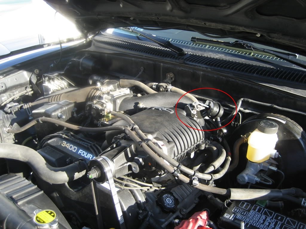

    Awesome... You think you could snap a picture of the actuator your talking about? Would really appreciate it.
    Thanks man.

    Here's the one on my truck. Obviously I have a first gen tacoma and the supercharger is slightly different for the second gens. For your truck, the actuator is on the back side of the supercharger (towards the firewall) and sideways. Essentially you'd zip tie it the way it sits at idle (which would be under vacuum). Under boost, the boost pressure from the supercharger will funnel through the vacuum line and push on the actuator. The actuator will close a valve in the s/c and boosts all pressure to the engine. By zip tieing it open, air will recirculate and prevent all the boost from going into the engine.

    NOTE: That picture above is not from a 2nd gen supercharger. That valve is not in the same spot on the 2nd gen, if its even on there.
