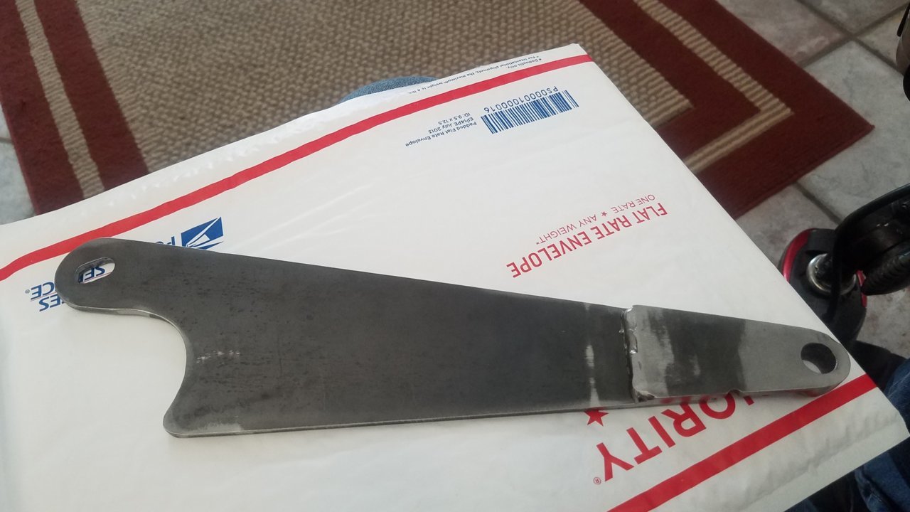

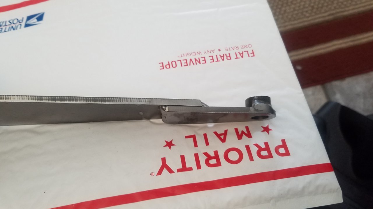

    Here's the raw bracket from plasma cutter. I couldn't find anyone with the ability to do a offset that would do a job this small.
    So I'll tig the tab on the bottom to get the offset. I have the same size spacer to weld on the bottom like factory.
    20191230_232936.jpg 20191230_233456.jpg 20191230_233504.jpg 20191230_234535.jpg
    There might be a tiny bit of fitment issue in the circled spots. I need to dig my SC out tomorrow and check

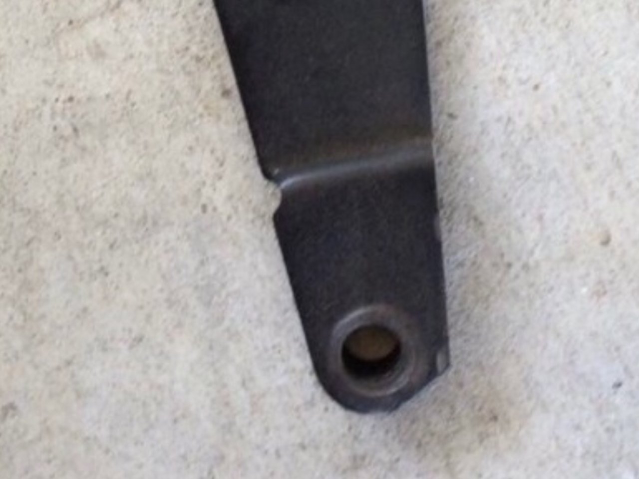

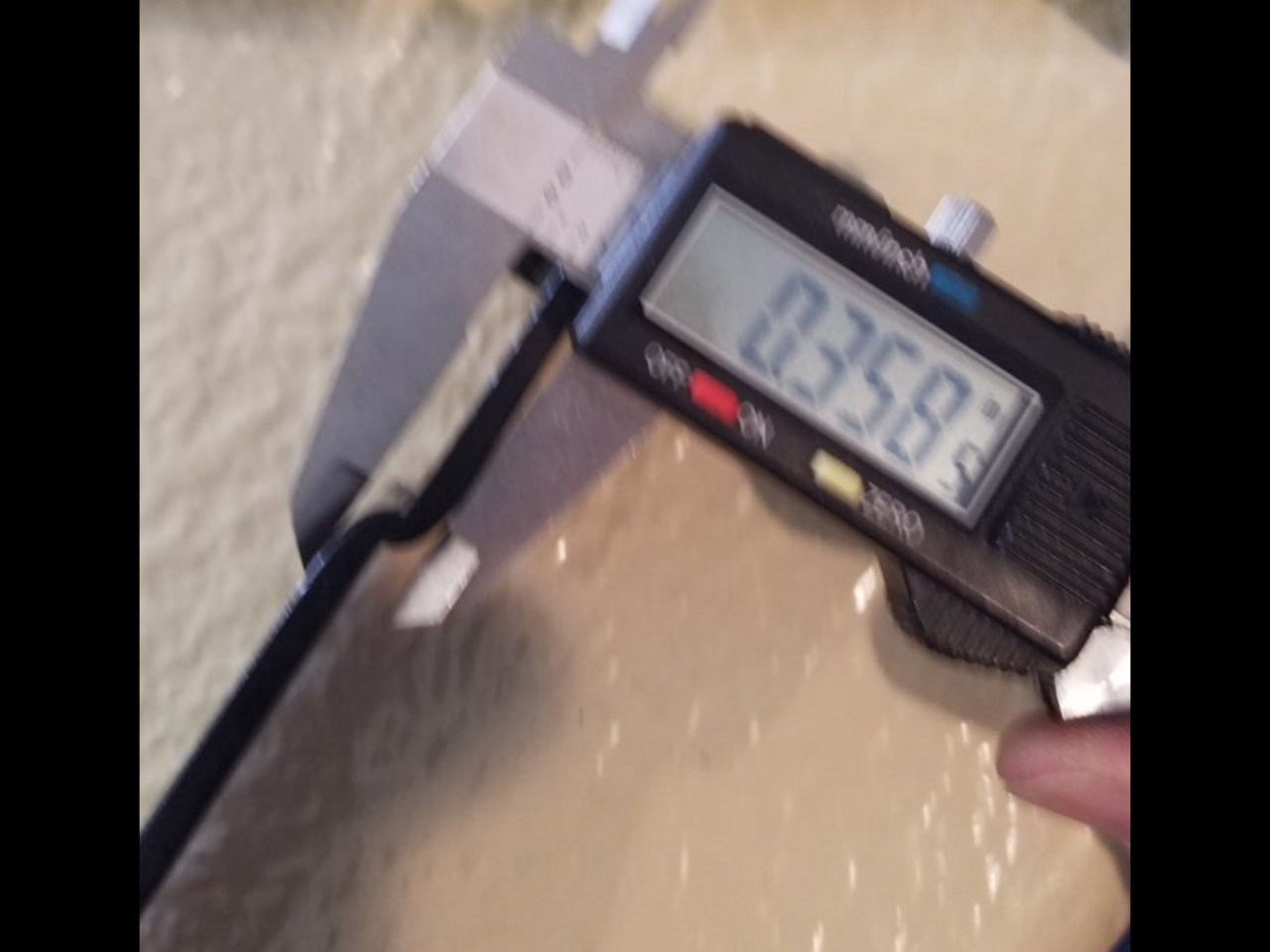

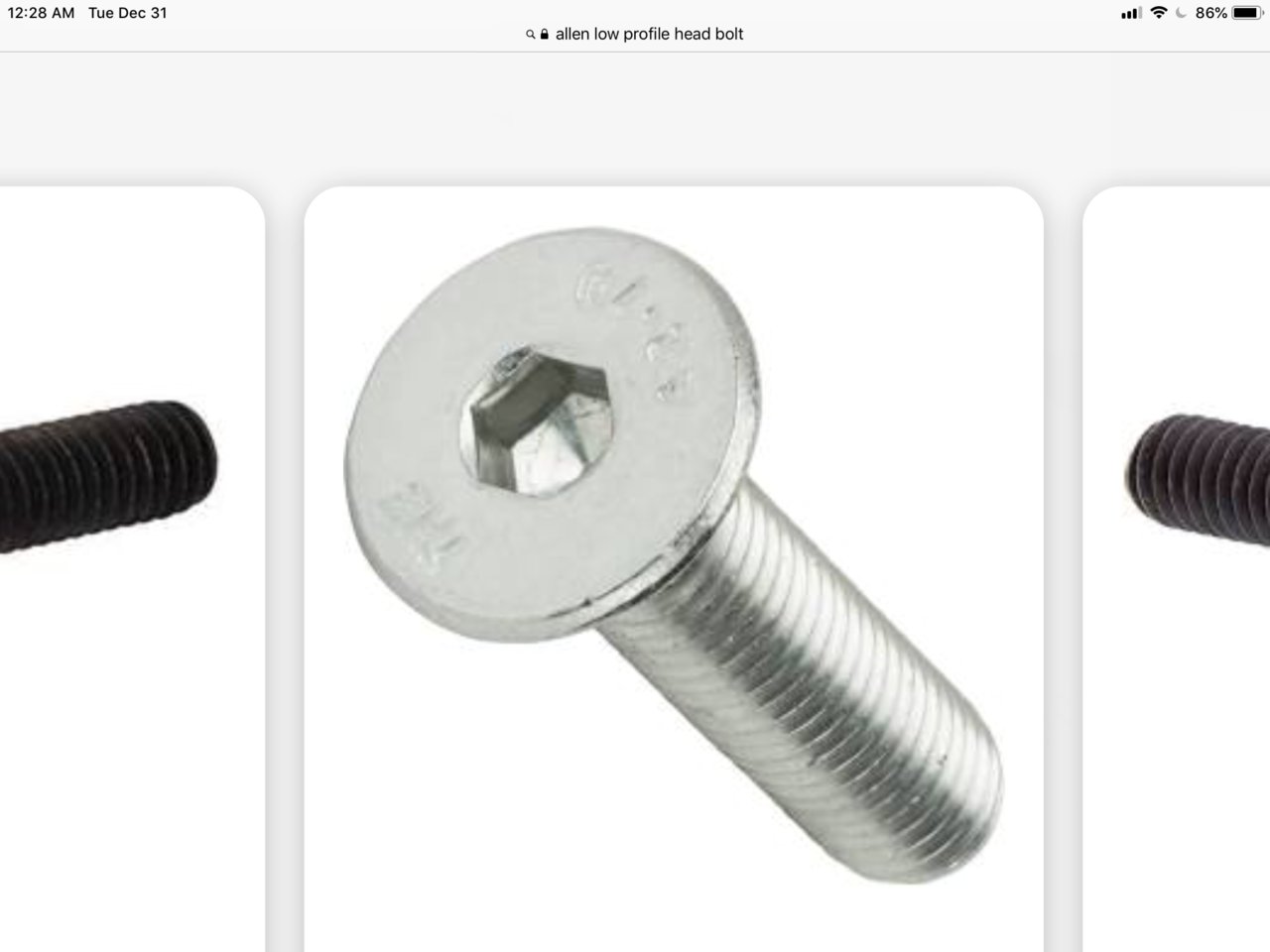

    Looks pretty good,
    Yea do a test fit, this part actually is a lot tighter fit then one would think.
    The lower belt is SO close to hitting the bolt and the step back plate hitting the belt too as it fits inbetween the belt and the engine metal cover shown here.
    Tight tight fit.
    I was actually thinking of replacing the lower bolt with an Allen key low profile head but didn’t get that far, that way there would be zero issues with the bolt head and the belt.
    The reason the top bolt hole is rounded is actually to be able to get the part in and out easier because of how tight a fit it is.

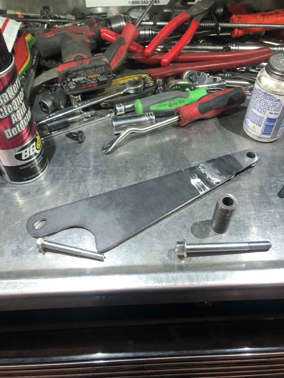

    First one is being shipped out today to @94jdmeg6civic for test fit.
    20200115_150650.jpg 20200115_150617.jpg 20200115_150719.jpg 20200115_150709.jpg
