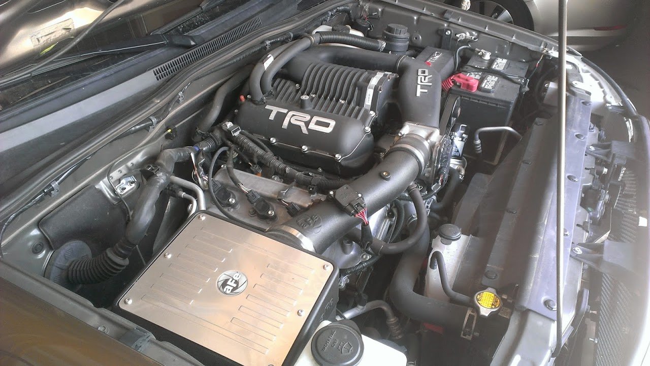

    Hey guys quick question. I have a trd charger with stock air box assembly. I installed the volant CAI and it killed my MPG. Gadget (URD) set it's because the Volant really messes up the MAF Cal and even adding their MAF Cal Tuner was a roll of the dice.
    So my question is, he recommended AFE. Those of you with the AFE Intake, did you notice and change in your MPG? Trying to decide if I'm gonna keep the stock assembly or give it another try with AFE. Chime in quick. Gonna buy today.

    I have AFE. I noticed very slight increase in mpg and slight increase in power. No reprogramming just what Toyota does for S/C. I get low 20s in the city and around 24-26 highway at 65. I also drive slow and try and make a game out of the Scan Gauge.

    Afe stage 2 si
    Gadget knows what he's talking about.

    Yea i put on the AFE Stage 2. avg 18mpg driving conservative on hwy

    For anyone else interested, the Airaid works well with the s/c. My mileage is exactly the same as before the install of either. Airaid was on for exactly 1 trip of roughly 100 miles before s/c install

    Its very surprising just how much time is spent in vacuum tho, with the blower basically costing a mere 0.5 hp
    Running stock and then the afe I seen zero mpg changes......that damn volant causes problems for people both force fed and naturally aspirated. The problem is that its random.. Random as in, not all owners have issues with that intake. Some have the check engine light come on, and others dont.
    Many many happy customers running the afe stage 2 si both here and on the xru forum.
    I advise installing the afe, then listing that volant for sale in the buy/sell/trade section.
    Gadget isn't trying to upsell u on an intake..... He's just being honest. The maf calibrator is only as good as its tuner (u know any good tuners familiar with the r4 programming from split second?)
    Odds are things will be easier with the afe.
    Shouldn't need any calibration to run well. This may look like it costs more upfront, but it will save u money on buying:
    Maf calibrator
    Installation of maf calibrator (time consuming and in a tight spot)
    Tuning costs
    Future tuning when u make other hardware changes
    Less items to cause problems (faulty wiring/poor soldering/etc)
