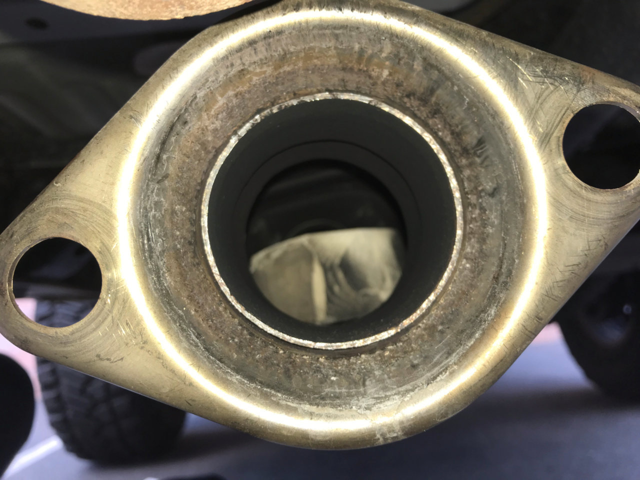

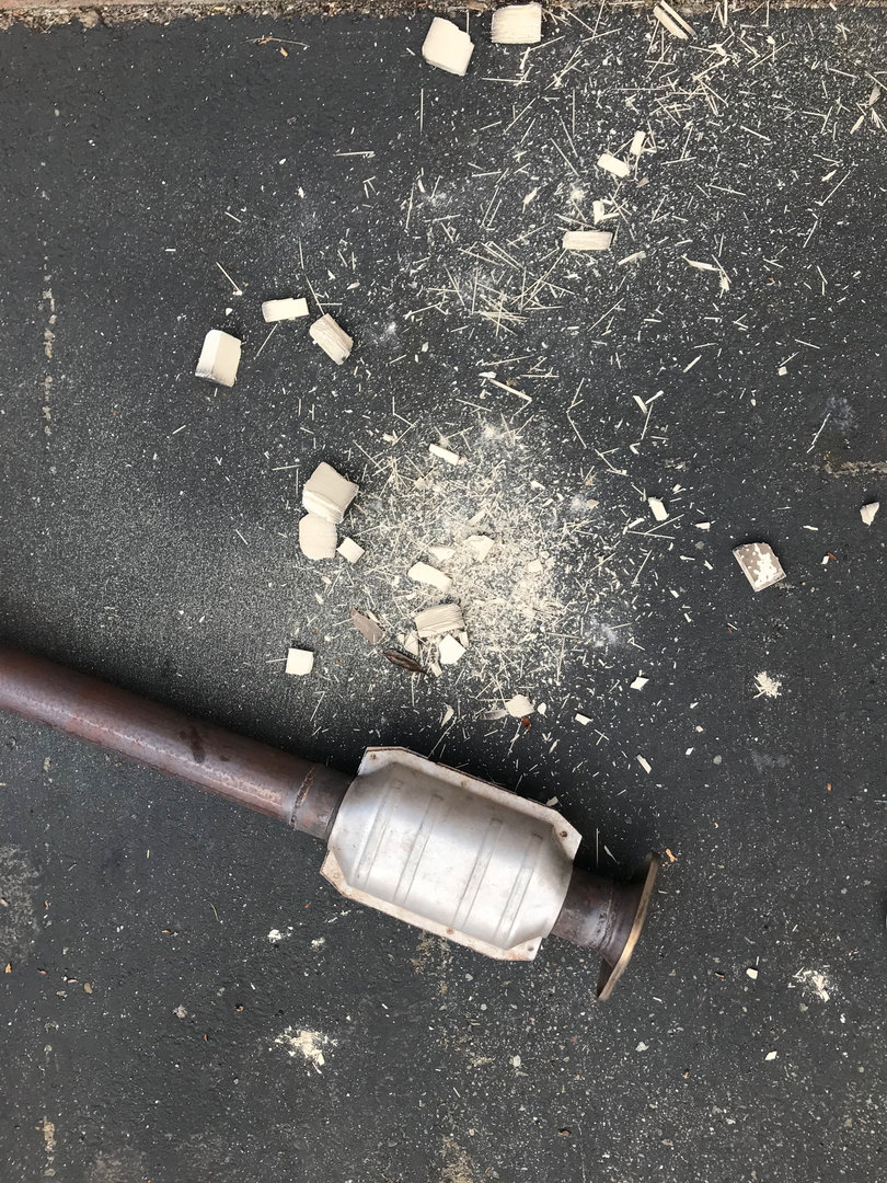

    I found the issue. After I did the bypass test, some of the power came back, but I knew it wasn't 100%. During the test drive, I went about 1/4 throttle and heard a loud POP and saw a puff of black smoke in the rearview lol. I eased off and went back to the warehouse and plugged everything back on. The next morning on cold startup, I can hear a noticeable rattle coming from the exhaust. I drove it like this for a few days until I had time today to crawl under there again. I knocked it around with a rubber mallet and sure enough the Magnaflow hiflow cat made a clank clank sound. I took the catback off and saw this,
    I added this to lessen the exhaust fumes, but after 2yrs, it wasn't having it anymore. I decided to just gutted it out for the time being.
    I put the catback back on and took it for a spin and life is all good again.

    Part bypass and majority catalytic converter. Glad you were able to get it sorted.
    Was any of that converter material balled up and deformed?

    I have a dent on the outside housing of the cat from an offroading trip last year. Whatever Magnaflow uses to hold the "honeycone" part of the cat must have been compromised by this dent. I think it eventually broke causing the honeycone to shift and move freely. It must have rotated somehow and ended up plugging and restricting the exhaust flow. It was still one chunk. I either had gut out the cat by breaking up the material or weld in a new cat. For the time being, I decided to just gutted it out.

    Had a similar issue on my '01 Subi. Cat has broken, then bounced around and melted into a strange deformed ball.
