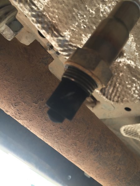

    have you tried pulling it off to look at the sensor?

    Not yet im going to later today

    Check that, check the wiring the whole way for any possible heat damage or anything. Anything that looks melted or crushed is probably a failure.

    The gauge start up procedure is completely normal. It just doesnt read correctly. Ill check all that later today.

    Is it plugged in?

    Yes?? That was the first thing I checked.

    The electronics are fine, i wiped the sensor gently as best I could, started it and still the problem remains.

    How about all the wiring? I'd pull it out and check all of it to look for any heat damage.

    No heat damage. Its routed through the cab

    Did you use any antiseize on its threads during initial installation? If so, silver or copper?
    If you shake the sensor, do you hear any rattling?

    No antiseize. When I had it out I heard no rattles what so ever.

    Ok. If you get a new sensor, make sure to only use copper based antiseize.
