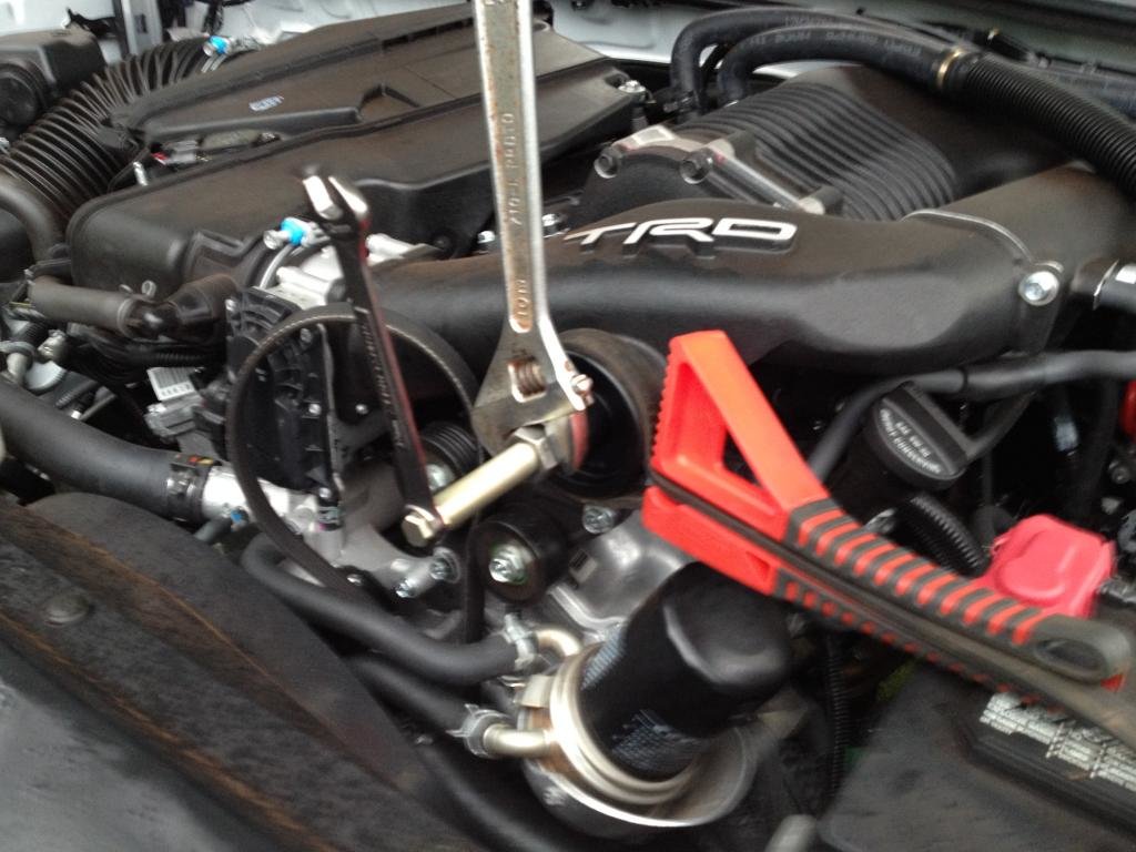

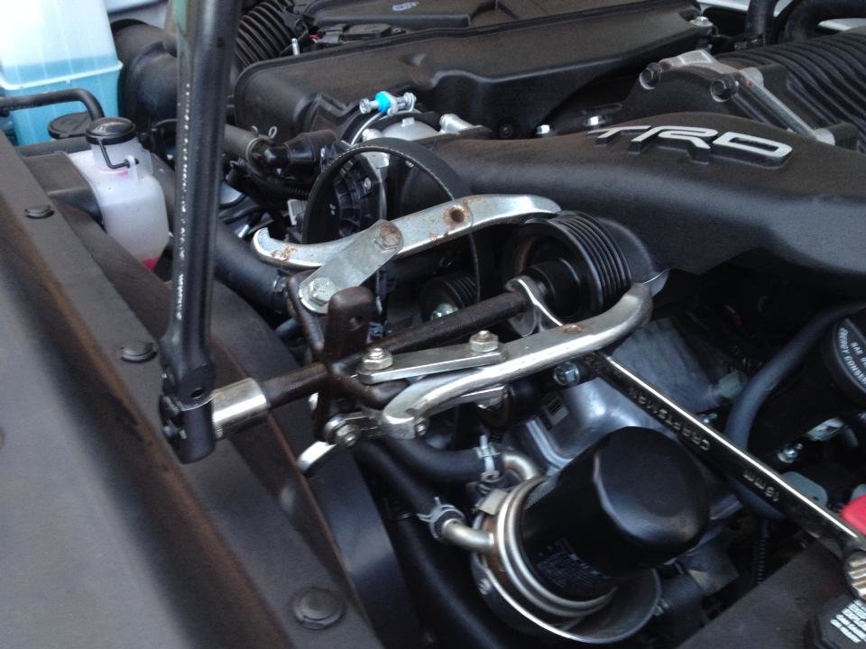

    Installing the 2.85 pulley is a one person job. Another person really would get in the way. The wrench can rest on the truck to keep it locked in place.

    This is actually pretty bad advice. If that shit slips off and you have to reset and start over, you run the risk of having the pulley get stuck on the snout from heat transfer to the snout bolt. Then you're fucked.

    Slip off? not going to happen. There is an anchor holding the pressor tool onto the snout. The only way it would slip off is if someone was helping you and the extra hands hit the wrench. Use quality tools and you will be fine. Same with the strap wrench.

    I'm talking about the wrench. Holding a strap wrench, a wrench to hold the tool in place and a wrench to turn the nut on the tool to push the pulley on. Unless you've got 3 hands, having a wrench slip off suddenly is gonna fuck shit up.

    so we are on the same page... putting the new one on, left hand holds front wrench, right hand holds far wrench, and strap wrench is what I have locked. No need for other hands.
    Removing is when you have the wrench wedged on battery, and it is not going anywhere...

    Ok, and when it slips off and you have to reset and the pulley gets stuck halfway on the snout, are you gonna personally come to everyone house and fix it? That is a dumb thing to recommend to everyone.

    if you are talking about the strap wrench I can't see how it could. Having done this procedure the only way it would slip off would be if it was initially set up incorrectly.
    So I will advise people then that if they don't know how to use a strap wrench and don't do a practice run with the old pulley on to make sure they understand how to use the strap wrench in this application, then have somebody help you hold the strap wrench. Just warn them the new pulley will be extremely hot and could cause a burn injury if an arm contacts it.

    Basically it comes down to if the owner doesn't feel capable or have all of the right tools, get a second set of hands. Plus, another set of eyes never hurts either.

    As tor said , Having a buddy around to take a second look sometimes saves a dumb mistake from happening
