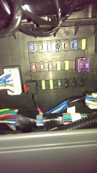

    So I'm looking at the instrument wiring diagram in my Haynes book in an attempt to understand which wire is dash lighting and which wire I should target for keyed ignition. I'm ready or work on my gauges. Any recommendations?

    This is behind the coin tray.....this is where I fused tapped for my afr gauge that is powered upon ignition. I believe it's the wiper motor. If you look in the diagram in the owners manual itl tell you exactly what it is. .......works for me.:thumbsup:

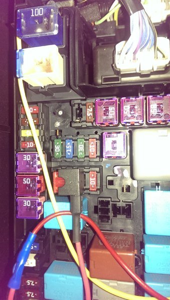

    This is the one I fuse tapped for my boost gauge. I believe this one is the left head light. Flip the cover over to confirm. This one is in the bigger fuse box under the hood. I only need my light for the gauge to be on at night....which is why I tapped it into a head light. DONT MESS WITH THAT YELLOW WIRE!!!!!!!!!!!!

    Those little connectors are handy.

    Yes. Those. Auto parts store?

    Yup....I believe they are mini fuses so you gotta make sure you get the correct fuse taps....take a fuse with you to the store.
