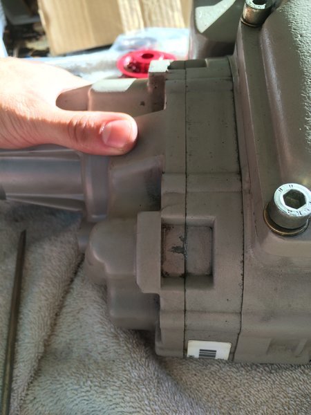

    Need some quick help. What's the best way to pry this thing off, I'm starting to chip it. Thing is really glued on there

    Try a flat head in the corner of that box where you were trying to pry and mallet the screwdriver? To try to break the seal a little?

    put a socket in one of those squares, then a prybar to pry against the socket, should work...

    I used a pry bar.was kinda hard

    The socket worked real easy. Thanks man.
