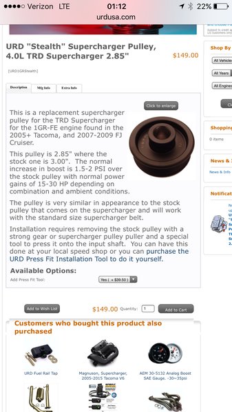

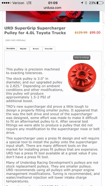

    Any difference between the two?
    My warranty is up so I dont need the stealth appearance. image.jpg image.jpg

    The red one is a tiny bit smaller

    Yeah if you're out of warranty then go for the cheaper one. I wasn't worried about warranty too much but didn't want the bright red pulley in there so I went with the stealth one.
    Theres no different in performance. The stealth has the same profile as a stock pulley but the inner ribs are 2.85 OD, IIRC the red one is 2.85 OD but the actual pulley size is slightly smaller than the oem just because its not trying to hide anything

    so with either of these i won't need a new belt correct?

    Correct
