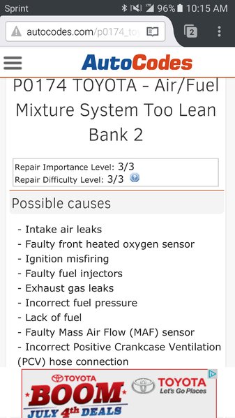

    Check your intake for leaks

    What kind of reads are you getting from your wideband

    My wideband is still broken, I found that I still have a small exhaust leak , the leak was horrible, I had a shop weld all the joints and they missed a spot because I can hear and feel the exhaust leak with my hand. I checked vaccum leaks and there were none, and my intake was secure as well.

    The peak will need to be before your o2 sensors to cause the code you are seeing. The only possible places for those leaks will be the flanges. Any slip fit sections will be post o2 sensors

    I had that code for weeks and couldn't get it to go away, went to three dealerships, two of which told me to "just take off the supercharger" :rolleyes:
    Third called in a 'Master Tech' who diagnosed it right away...there's a port on the back of the supercharger (EGR port maybe?) that had become uncapped and was creating a vacuum leak. Be sure to check any hose going into/out of your supercharger and make sure they're on tight, no leaks. Check all ports to make sure any that should be capped, are. That fixed my issue.
    Afterward I did a search on here for that code and the supercharger and found at least two other people had the same exact cap fall off the same port, creating the same code. It's not uncommon. If everything looks good, then start checking for leaks in hoses or uncapped ports elsewhere in your engine bay as any vacuum leak will create a P0171/4 code.
    Also, a dirty MAF sensor can throw it as well. Won't hurt to give that a cleaning (super easy to do yourself) just to see. Other less likely causes are leaks in your exhaust or a bad O2 or air/fuel sensor.
    Make sure you don't use too much boost while your driving your truck with this code being on. Means you're ECU is causing your truck to run lean and that can do big damage to your engine over time, especially if you're forcing it to work even harder (boost).

    I missed this post somehow. I bet you $100 that code is due to your exhaust leak.

    have a bad leak before my o2 and never got a code

    Thanks alot, I had a bad bad leak and it wasn't throwing a code, got it welded up and it was much better and you could tell the difference, then a 100 miles worth of driving the code pops up. Ill get it fixed again and report back
