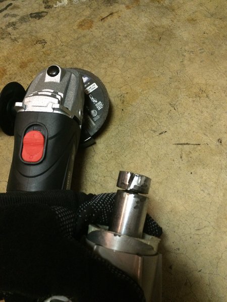

    If it makes you feel any better I exploded another set of bearings when I got a socket stuck on the pulley shaft just as I was about to finish last week...s/c's been sitting in the garage till my new koyos come in today or tomorrow.

    And you literally can't buy these koyo bearings anywhere in the US without such a long wait time. These are coming in from the UK.
    Edit: just checked usps and they're at my house! Do or die now.
