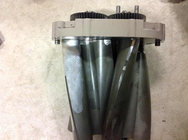

    So...do I need a new rotor pack?

    No. Looks like just the coating is bad. How do the bearings feel? Any play?

    Bearings look melted. The needle ones haha got new ones though
    So I'm good even if the coating is bad?

    Any play on the rotor pack bearings?
    No some people even strip the coating off haha. It's supposedly better with it but meh

    Can get new rotors for 400. Yikes. Haha
    I can move the rotors up and down a bit. That bad?

    If you can pull the gear in and out. That's bad. If you can so ready the rotors apart slightly that's fine

    Nice. Then I should be good

    Should be fine! Nothing could be worse than me LOL almost been a month...
