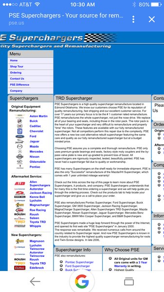

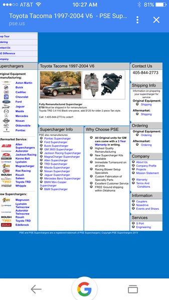

    I found this place that does rebuilds. But it sounds like you can buy a remanufactuted SC also. What price is for what on these 2 pictures?

    I think when its time to rebuild mine I'm gonna send it to Steigmiester or w/e and have it all rebuilt and bored out

    I haven't even bought a SC yet. But it has 173,000 on it and everything is there. The guy said the nose cone bearing needs to be replaced for starters

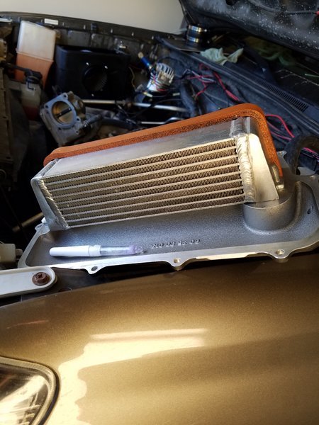

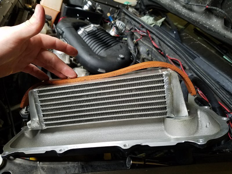

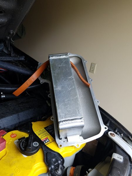

    Long story, my truck got submerged entirely underwater. Working on the rebuild. This orange seal came off. Question is do I need it and what would you do too reattach it if I do need it.
    Thanks.

    I'm thinking it's just an air gasket. But how do I get it to stick back in place? Didn't feel like it ever had adhesive on it

    It uses an adhesive which doesn't last long. Many people have found that foam strip missing, as it has bee sucked through the engine. Threads abound on XRU. Some have just used a quality high temp silicone to re-apply.

    So I'm thinking I could super glue it back then

    I would verify the operating tempurature of superglue before committing.

    Melting temp of dry superglue is 368°F. will that be enough?

    Superglue applied.Won't be putting it all back together till Thursday. I want everything good and dry from the water damage
