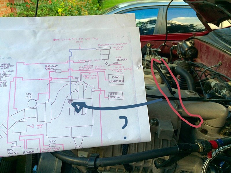

    Success! I may have found the p0171 culprit. However I may need some help, I'm trying to figure out where these vacuum lines are supposed to go or be capped. I do have the 7th injector kit so I'm not sure if this changes the way these vacuum ends should be routed.
    The guys that installed my s/c and URD kit may have overlooked these areas.
    This line starts under the L piece but doesn't go anywhere, I put my finger at the end of the line with the engine running and its sucking in air. Where does it connect to or should it be capped?
    To note, when I bought the s/c used this line was connected to where the blue arrow, or boost port is located.
    Now the blue arrow I'm pointing to, or the boost port was never capped after it was installed and as seen in the pic I capped it myself days ago to still end up with p0171. If these are supposed to be connected or capped off each, or one or the other please say so. I do not have a boost gauge.
    Now this end here as I feared is often forgotten, checked it couple minutes ago and it was left open sucking in air. As pictured here I capped it off. This is by the throttle body. If I'm reading correctly this is supposed to go to the IAC check valve?

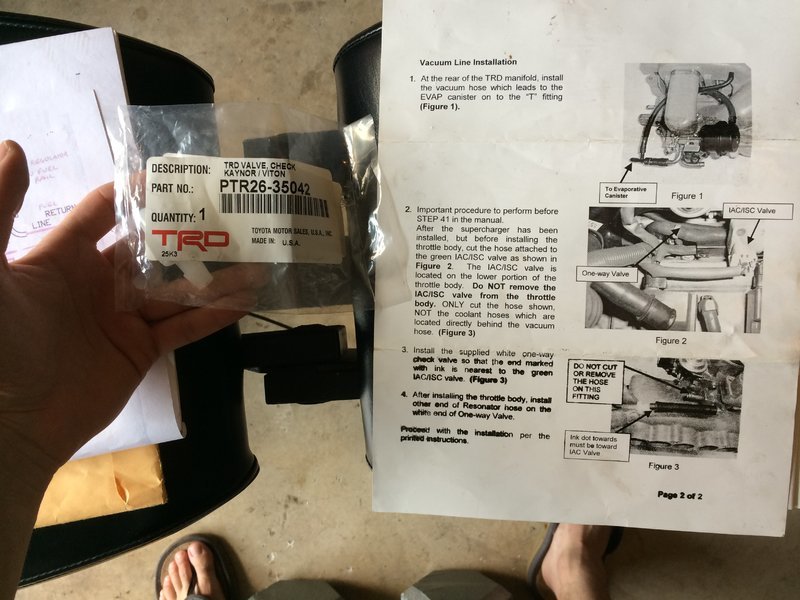

    Which is what the guys completely forgot to install - was left in the box. I'm a bit confused at reading step 2 in the supplemental instructions.

    First pic, goes to fuel pressure regulator.
    Second, should have a tee, and go to the Fast Idle, as well as that check valve. If that make sure that check valve is facing the correct way.

    The one right by the throttle body is not supposed to be capped. It runs to the throttle body. The one from the boost port runs to the FPR then your urd and boost gauge are t'd off that

    Ok so the boost port that I have capped right now goes to the black FPR on the s/c? So in the first pic the line that comes from under the L piece goes where? Capped?
    I'm reading that the check valve points towards the s/c. I'll get to this tomorrow morning but supposedly I need to cut a line down there to install this.

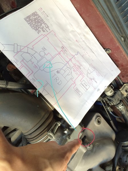

    I've only had this on for about a week and a half and I know this has to be it. The EGR port is already being used by the 7th injector. When I get on the throttle there's a hiss sound that you can hear so I know it has to be a vacuum leak and this proves it - for starters, the line circled in red was never plugged to anything so it's just a line sucking in air. 2nd, there are two ports that were never connected to anything! And 3rd I had a gut feeling they never installed the IAC one way check valve which is still in its bag unopened.
    And reading this gives me the confidence that others had experienced this same issue in the past (when this part wasn't widely known)
    http://www.4x4wire.com/forums/ubbthreads.php/topics/959272/Re:_TRD_Supercharger_IAC_check.html

    Ok so now I'm confused. So having the grey charger is that any different regarding whether the port next to the throttle body is capped or not? Given my truck is an 03 - which you said connects to the vacuum throttle opener, that an 03 doesn't have.
    I just want to be sure I'm gonna be routing this the correct way. Is the vacuum diagram that I pictured based on earlier year models?
    Another honest question, am I reading on the diagram that the line that connects to the "fast idle" is the line that I'm supposed to cut to install the check valve? In which I have to tee from that to this port that I have currently capped?
