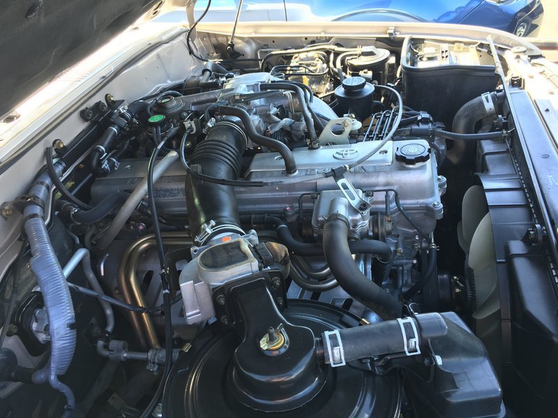

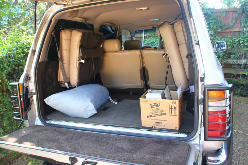

    Wanna buy it? Only 94.5k miles. Not the FJ. Spent two years looking for it.

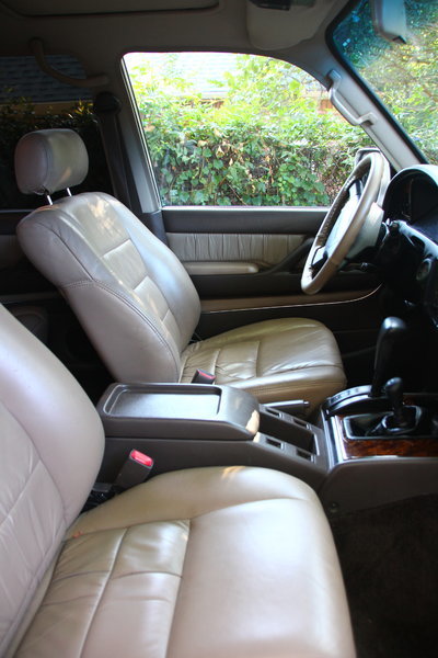

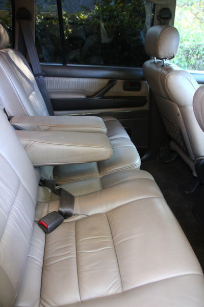

    I'll keep you in mind. I'm not going LS until 1st quarter 2017. My goal is Harrop e-lockers before the end of the year and then the engine.
    I'm still stunned how well preserved it is. It took me two years, but I think I found a good one. There isn't even a pulled stitch on the seats.

    Please do and that is a beauty!

    I love this thing. Power sucks, but it's a total land yacht. 4700 lbs. gas gauge moves on every trip. It's awesome.
