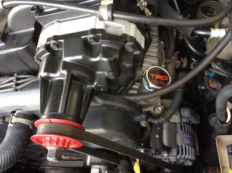

    Yea somethings wrong, as you know high speed did my rebuild and I'm at 6000 feet with 2.1 pulley and pushing 8 pounds of boost or so,
    So your sure the pulley is not slipping?? The key is in good shape and torqued to specs, my old 2.1 pulley actual wore out the key slot and I had to get a new pulley.
    Look at the TRD pulley and see if there is any wobble in it from the side while running.
    Why did you switch to the 2.2 pulley from the 2.1 pulley? You know you loose 3 pounds of boost by doing that

    So your sure the TOP TRD 2.2 pulley is not slipping?? The key is in good shape and torqued to specs? my old 2.1 pulley actual got worn out in the key slot by the shaft and I had to get a new 2.1 pulley.

    How can you hear it slip? Is it squealing, I don't think u would hear it if it was slipping. I have
    never hear mine slip and I know it used to before I put on the lower tensioner for the belt.
    Maybe it's the AC belt you hear. Maybe the boost guage is not showing the full
    boost from a vacuum leak in the line? Or connection?
    Maybe you have a bad belt, or poor quality belt because I put a new belt that was not
    from Toyota on my super charger right after it was rebuilt and the dam thing
    broke 3,000 miles after it was installed, that was a first. So Replaced it with a belt from Toyota, cuz the belt should
    last 50,000 to 100,000 or so depending on how hard you run the charger. I would lake the belt off and look at it
    for burn marks or slipping wear marks and probably just replace it since it cost 20.00 or so,
    Check every vacuum hose with carb cleaner, all it takes is a small vacuum leak
    and the charger will not run correctly. Everything has to be perfectly In sync for
    the supercharger to be running its best, this I know.
    I know a lot of maybe questions,
    If it is slipping, your boost guage will show erratic boost and not consistent boost and your saying you have consistent boost.

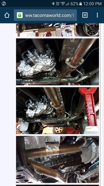

    I know urd took there spec u exhaust system for the taco off there web site to redesign it. The one you have a pic of is there mk3 system. I would imagine they put it back on there site soon.

    I've never actually seen the Spec U system, but having the URD 4x4 Ypipe, I can say it does cross in front of the trans crossmember like in the picture, and not behind it

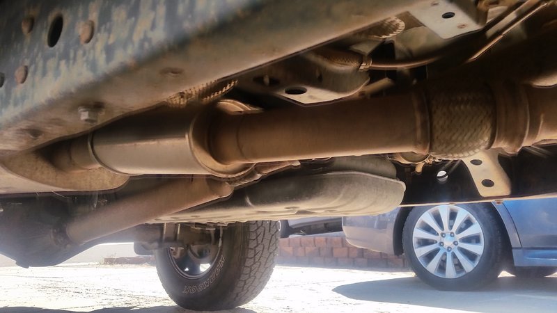

    A better picture, the only part of the exhaust that dips below the frame is the tip of the resonator only by a inch maby a little less.

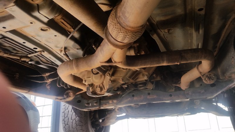

    I adjusted mine and was able to get the flex pipe/resignator 100% above the frame.
