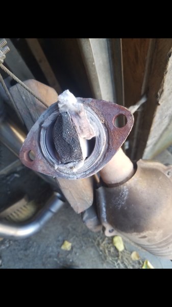

    Video of airbox will have to wait. Last night I finished my drive from Cali to N.Y.. About 400 miles left of the drive started having multiple cylinder misfires (generic code) at one point I got it to say cylinder 2,6. . If I shut the truck off and turned it back on it would go outta limp mode and I could continue to drive. Would only happen in 5th gear. So higher load. Thoughts? Bad gas? Tossed some dry gas in finally with ten miles left of the trip and haven't pushed into boost to see if it's corrected itself yet. Bad rear driver O2 sensor too (probably completely unrelated) Also I'll mention again I hydro locked this engine about 3 months/6000 miles ago as some of you probably remember

    Honestly no I didn't. Being on the road I have a small batch of tools is all. Back home now. In changing out rear driver O2 sensor. I found front oem cat to be toast. 90% clogging the pipe before the rear "cat" excessive back pressure on that side much? Could cause some issues but I don't know engines like you guys do. Would it cause misfire being this blockedScreenshot_20161012-131413.jpg ?

    A misfire can definetly cause that. I drove 500 miles on my truck like that. No misfire, very high boost reads, knocking if I wasn't careful, and huge loss of power(was limited to about 45mph uphill)

    That'd definitely cause misfires. Same on my Subi. Was a ball of cat material.....after about 190k miles. Would occasionaly bounce and block the exhaust. Misfire city like the Independence Day fireworks.

    Clogged cat will also cause your truck to run hotter. My truck runs 185-195. 205 on uphills in 100+ degree outside tempetures.
