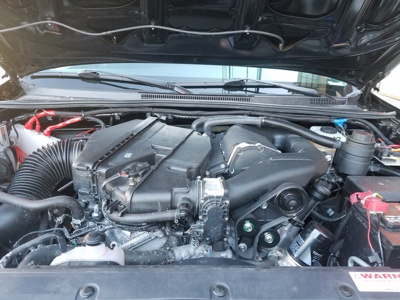

  15. Oct 15, 2016 at 9:52 PM
    #3195
    eon_blue
    Mar 4, 2016
    #180213
    70,081
    Azusa, CA
    Since we're on the topic of controlling boost via load/throttle, forgive me if this is a dumb question but I haven't for the life of me been able to find an answer for it since I got my truck (manual trans)
    Why is it impossible to achieve boost in first gear? I can start to see some in 2nd if I'm really opening up the throttle, but it isn't until 3rd gear that I can hit 5 or 6 psi. 3rd gear is when it feels like a fire gets lit under my truck's ass, but 1st and 2nd don't feel any different than it did N/A. Maybe I'm not pushing my RPM's enough (I almost always shift around 3k, 3.5k tops)
    Again sorry if this has an obvious answer but it's got me wondering for awhile now.

  17. Oct 15, 2016 at 9:55 PM
    #3197
    inwood customs
    inwood customs Roaming potato
    Sep 11, 2016
    #197024
    4,719
    Dave
    2006 v6 potato bugTuRD
    K&n, flowmaster, plastidip, chipped, hids, daves
    Thats news to me.
    Roots blowers should boost on demand regardless of gear or rpm as long as theres load.
    Maybe a bypass issue?
    TashcomerTexas likes this.
  18. Oct 16, 2016 at 7:25 AM
    #3198
    Torspd
    Torspd Tor-nication
    Sep 18, 2009
    #22958
    26,471
    Tor
    The Great America!
    MMVI 4.4L 4x4 Access Cab
    Torspd Custom Turbo kit [] Borg Warner 9180EFR Turbo [] Haltech Elite 2500 [] TiAL Q BOV [] TiAL V44 Wastegate @ 15psi [] CP Pistons [] CP Carrillo Rods [] ARP Head studs [] ARP Main Studs [] ARP Header - Head Studs [] Ported Heads w/ 1mm oversized valves intake/exhaust [] Brian Crower Forged Stroker Crank [] Darton M.I.D. Sleeved Block [] Kelford Camshafts [] Torspd 160* T-stat mod [] APR Large Fuel Rail [] Walbro 460 LPH E85 Fuel Pump [] FueLab FPR [] APR T56 Conversion Kit [] KP RACING Built T56 [] McLeod Racing Custom Twin Disk Clutch [] One Piece Aluminum Driveshaft [] MGW Shifter [] Custom lowering kit [] Ohlins Front Coilovers [] QA1rear shocks [] Custom Ron Davis Radiator [] Dual SPAL Electric Fans []
    Do you have aftermarket gearing? Larger tires will create more load on the engine, with stock gears, for an example.
  19. Oct 16, 2016 at 11:22 AM
    #3199
    eon_blue
    Mar 4, 2016
    #180213
    70,081
    Azusa, CA
    That's what I feared, that it wasn't normal behavior....I'll have to try and find a shop around me that knows what to look for. Surprisingly most Toyota dealerships I've been to out here want nothing to do with anything related to the TRD supercharger. Thanks for the input
    No aftermarket gearing, at least not to my knowledge. Stock size tires, though they are E rated KO2s which are notoriously heavy. Wouldn't think that would make that much of a difference but maybe it is...
  20. Oct 16, 2016 at 1:09 PM
    #3200
    Torspd
    Torspd Tor-nication
    Sep 18, 2009
    #22958
    26,471
    Tor
    The Great America!
    Then check your belt tension, and bypass valve.
    Easy test, remove the vacuum hose from the bypass valve. Cap open ends. Make sure it has full range of motion and isn't stuck. Then go for a test drive and see if you now have Boost where it should be.
    inwood customs and eon_blue like this.
