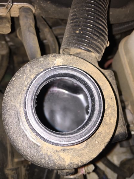

    Oh sweet jeezus.
    I tol ya guys to keep an eye on this thing recently :eek:

    Come on guys lol. I at least pop the hood once a month and just do a quick eyeball on all my fluids. Which reminds me, radiator looked a bit on the low side earlier this month, I keep forgetting to go grab another gallon of coolant.

    Just remember to check THAT resi with the key on, or engine running.
    As gadget pointed out, hearing the pump run doesnt mean its pushing coolant.

    Looks like there's some pink residue in the reservoir as well as needed the inlet hose/clamp. Fill and look for leaks.

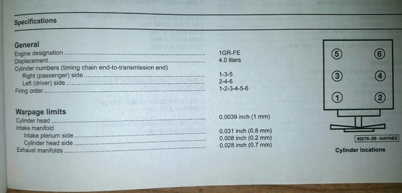

    So I was changing my oil at the same time I noticed this. Now I have a cylinder misfire. Any coincidence ?

    Fuckkk.
    Any idea which cylinder is the 6th?

    Oh fuck Me its the one under the blower :bananadead:

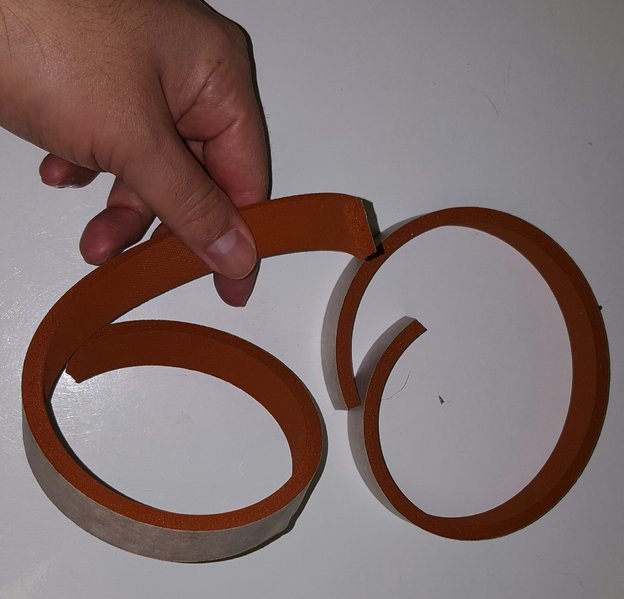

    20170214_184752.jpg If u DO wanna pull the deal apart, i hear theres a foam seal/gasket that is sometimes pinched and ripped when opening the case? (I didnt install my blower).
    Now, if u think u wanna go that route i suggest messeging whitebeauty (mark) over on the xru. Awhile back he got ahold of quite a few new ones from toyota which for some reason are hard for anyone to obtain normally. He most likely has a few left and may part with them.
    u only need 1

    I have a leak somewhere on my coolant. Doesn't leave puddles, but I have a pink residue on stuff around the reservoir. Maddening. Clamps all seem good
