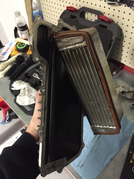

    Take a close look at the reservoir inlet/outlet. I found some evidence of dried coolant around the reservoir and tracked it to those connections. My reservoir inlet/outlet looked just slightly wet around the hose so I ended up partially draining the system and applying RTV to the reservoir inlet/outlet before reinstalling the hoses. This fixed inlet hose connection leak but the outlet continued to have a very slow leak until I installed a second hose clamp. The way my hose was routed caused some bending around that connection and kept it from sealing without a second clamp for support. If you do this make sure to disconnect the pump electrical connector or it will inevitably turn on while you are working on it.

    Well I found my issues.... Fuckkkkk looks like it's been leaking into the manifold :bananadead:image.jpg

    Ohhhhhh shitzsky. That aint good
