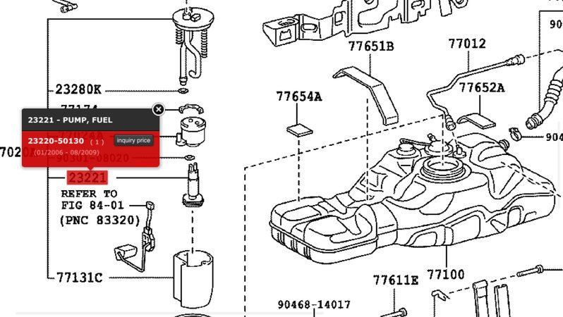

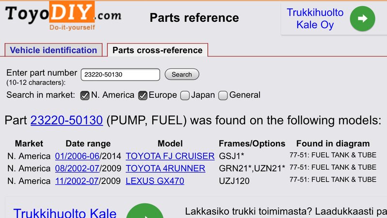

    Well, FJ, 4Runner and GX470 shares the same pump:

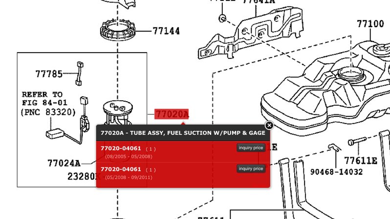

    But in Tacoma, the pump assembly is different, I don't know how different the pump itself is:
    Lower screenshots are from www.japan-parts.eu Good site to search the part numbers.
    I ordered Deatschwerks pump, $5 more and E85 compatibility as option for my later modifications.
