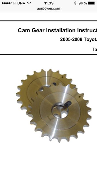

    Yes, he seems very secretive over what exactly the UCON is doing. He says it will work with the TRD or Bully Dog tuned ecus but works better with stock ecu. I dont know why that is since the UCON supposedly has full control (Then sends false signals back to ECU so it stays happy).
    Also won't sell the cam gears separately so unless someone knows where to get them you have to buy UCON to get cam gears.

    Seems like it would be easy to make them of the original ones, just machine one groove and dot at the opposite side? 3° different spot than oem. IMG_2907.jpg

    Quote...Seems like it would be easy to make them of the original ones, just machine one groove and dot at the opposite side? 3° different spot than oem end quote.
    Agreed, but probably is above most people's level here. I for one am not a machinist. Also would be downtime sending one gears out to machine shop or would have to purchase a second set of gears, send off to machine shop for mod, then install. It could be done but price and effort is probably not worth it for most.
