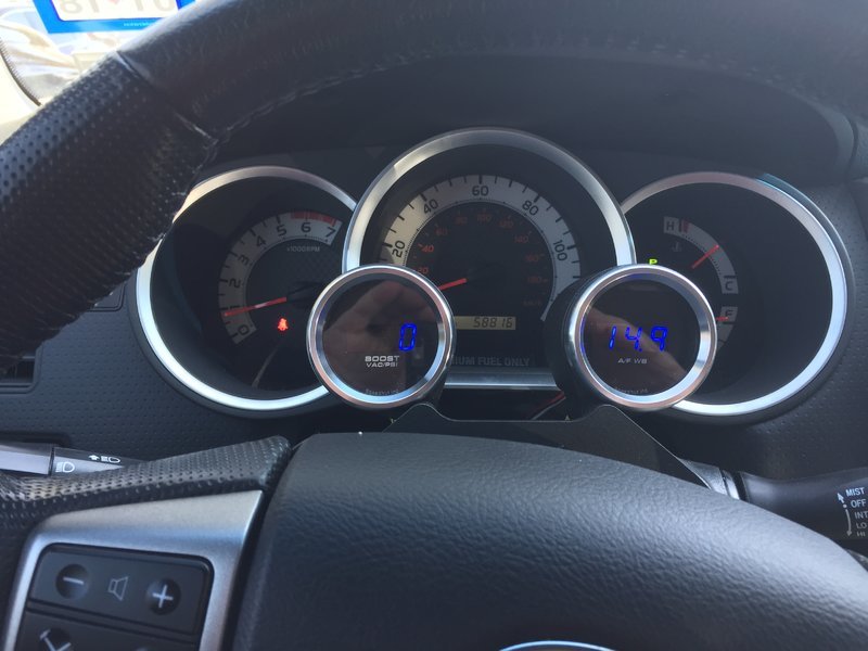

    The X series gauges are where it's at. I love mine.

    but theyre designed for dash mount.. I had to modify it a bit to make it work for the flex pod.

    Speedhut FTW!

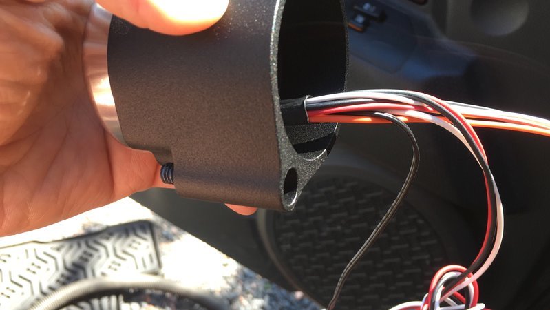

    Yeah I know, with mine I couldn't find a proper way to hard mount it without making something custom, so for now it is held in with pressure, it does hold very well, however.

    was this set up a pain to mount? require removing anything dash stuff/steering wheel covers?

    Two screws.
    https://www.cravenspeed.com/the-flexpod-gauge-mount-toyota/
    Now, the Speedhut gauges required some mods to hook into the Cravenspeed pods, but not all gauges will.
    Skootter14[QUOTED] likes this.
