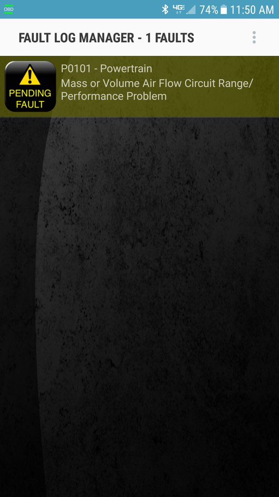

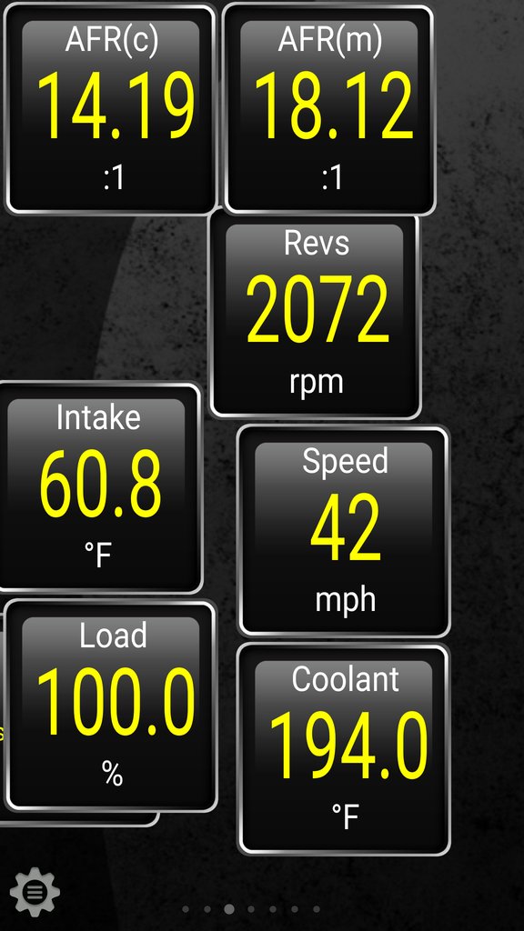

    Screenshot_20170710-081534.jpg Screenshot_20170709-115050.jpg Alright technical jedis can I thread jack this a touch?, could use a little help because I'm stumped. Got code p0101( maf sensor circuit), p0171 (O2 sensor bank 2 sensor 2) and maybe code p0161 another 02 issue anyways. All pending currently after being cleared 100 miles ago. Maf sensor replaced, throttle body, and intake cleaned, filter cleaned. Checked all hoses for vacuum leak. Carb cleaner sprayed all around engine with no change in engines tune. No visible exhaust leaks. Truck hesitates and has very little power. Running way to lean. afe stage 2 intake with pro dry filter, supercharged, 2.825 pulley, full exhaust with O2 simulators, oil catch can, walboro 255 fuel pump with filter changed ~18000 miles ago. Issue started on way home after half day of off-road/rock crawling, no deep water/no fast water crossings. Old maf now replaced was cleaned 2 weeks prior as well as throttle body cleaned 2 weeks ago. everything else has been on truck at least 8000 miles.I'm open to ideas of what to check next. Again sorry to thread jack- this thread just has the brightest Tacoma minds imo.

    What was the last thing which happened right before it started acting like this?

    Check your intake, I wasn't getting any codes but was chasing a big loss of power and it turned out to be a dirty air filter. It was covered with silt but it still looked white so I never checked it until I ran out of options.

    Ran it down a clean road without filter in place to eliminate that possibility. @Torspd , no real sudden issues noticed. On the way down to the off-road park, got gas at my normal place and it seemed weak but not throwing codes, filled up again right before park with 93 and issue went away. Then on the way home from the off-road park this issue presented itself..photos added to original post

    Which brand catch can do you have?
    Drive side bank is quite lean.

    What makes you say the drive side is lean and not both drive/pass? The 14.19(c) is the commanded and 18.12(m) is the measured reading. Maxed out the sensor at 18.12 so it could even be leaner.

    Ohhh. Misinterpreted. Read quickly. I see now.
    Things to try: bypass catch can, to rule it out from unnoticed leaks.
    Disconnect O2sim and see if amything changes.
    Do you have any form of an aftermarket tuner installed?

    No after market tuner. Will bypass can when I get home and check it again. If that fails to correct issue, will remove simulator

    Which MAF sensor did you purchase, OEM or aftermarket?
    Check your intake silicon couplings' hose clamps.
    Check the huge vacuum hose's ends from the intake tube to the passenger valve cover.

    Aftermarket maf sensor. Prior sensor was a Denso/oem. Im rather happy with the silicone couplings, was very careful putting them back together after recleaning old maf sensor and throttle body. I wasn't happy with the huge vacuum hose clamps on passenger side, so I replaced them with hose clamps. Removed that vacuum line for close inspection of hose damage. Didn't resolve issue.

    Still getting plenty of fuel?

    Honestly not sure how to monitor fuel amounts. I can try to gather data on way home tonite. Am I looking for "fuel trim"?

    STFT. If it is trying to add a lot of fuel but you're still lean.
    Have any friends with a Tacoma near by? If so, try swapping MAF sensors. As long as theirs is OEM.
