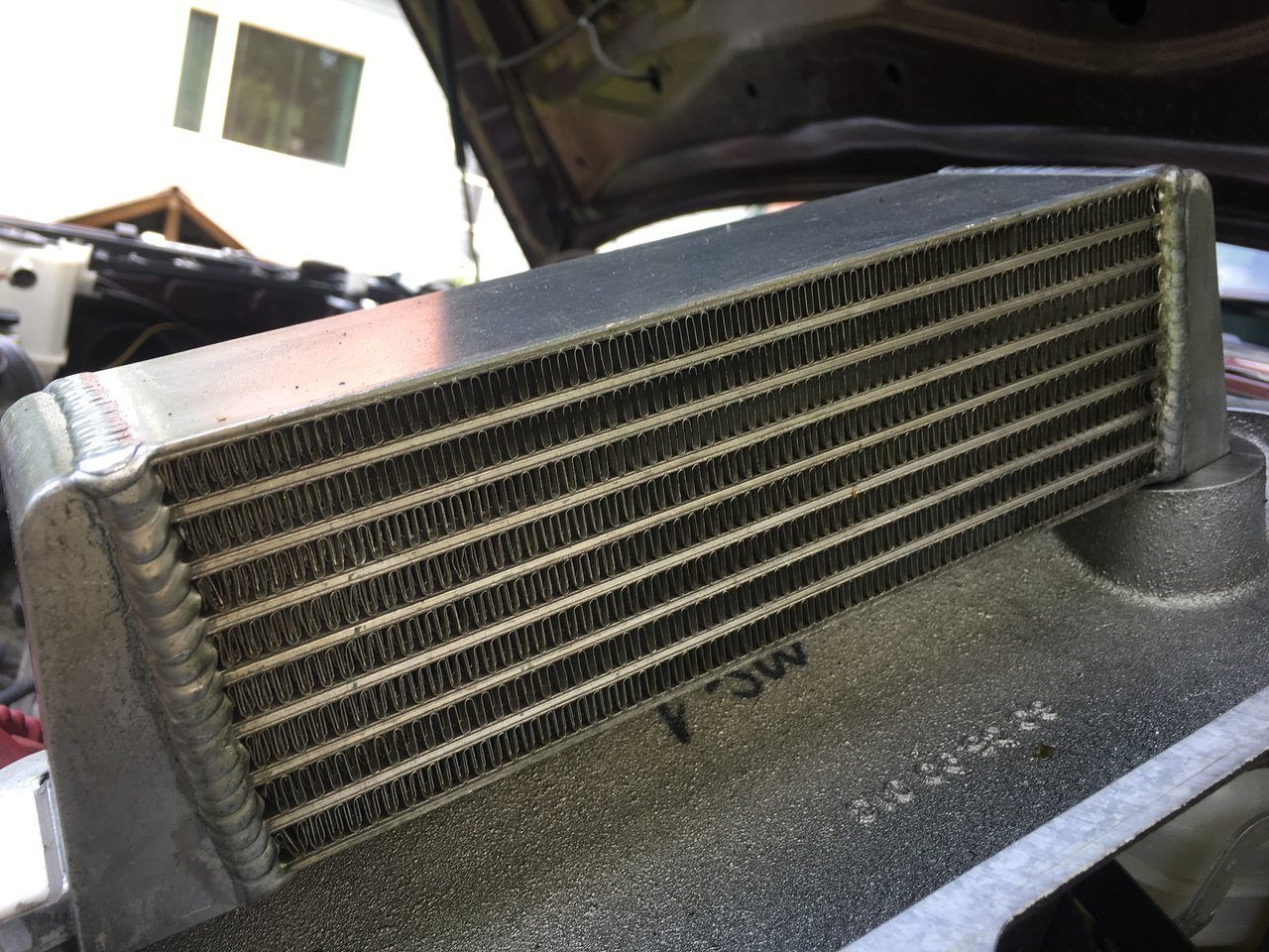

    Years ago, we almost made a little larger bolt in cooler......

    I love how these mod conversations come back around years later. The heat exchanger on our TRD setups are more than adequate. Even running on the hottest days these heat exchangers are always cool to the touch. The inner cooler on the other hand, should be larger.
    As for cooling the rotors, really only one thing works best and that's a 7th injector.
    Snakebite works on the TRD blower. Probably would want a Pulley bigger than 3 inch though

    I mean, Steigemeier wouldn't really be in business or be advertising if it didn't work lol. I looked into the port and polish before I installed but the shipping fees+P&P to HP gained just didn't seem worth it. Had not seen Snakebite at the time available to Tacomas.
    7th injector is definitely on the list when I get UCON.
    Company just rolled out a new bonus plan that's pissing people off; don't use sick days, get 125% bonus. I already burned a couple this year before the policy went into effect...so UCON+truck mods is happening in March for sure (if not before then :spy: ).
    I do think the full Snakebite package could be detrimental for us though, due to the smaller intercooler. For a track only truck it would be great, but after cruising around all day, or out in the desert, that extra boost/rotor speed would probably be to much, even with a 7th injector. @Torspd Do you think Water/meth and 7th injector would be able to keep inlet temps and rotors cool enough with almost double rotor speed lol?
    How would one go about modifying the inner cooler for more capacity. Wouldn't you have to redesign the entire main unit for a taller/thicker inner cooler for proper air flow across it?

    If the 7th alone wouldn't cut it for the snake bite kit, then you would have to likely go to meth as well. With considerations for a larger Reservoir and or larger exchanger. Because the capacity along with the cooling would help increase the time before heat saturation of the coolant.
    Remember that used to have the snake bite, who was on XRU started out around 16 PSI. Then did Heavy porting on the lower intake plenum and the supercharger where it mates to that plenum. Then did some porting on the exhaust ports of the heads. All of the porting dropped it down to around 10 psi with the same pulley size.

    I have a simple idea. What about mount another exactly the same cooler one on top of another an with just one hose going from one the the other wouldn't it make it all work?

    Yeah. It would.
