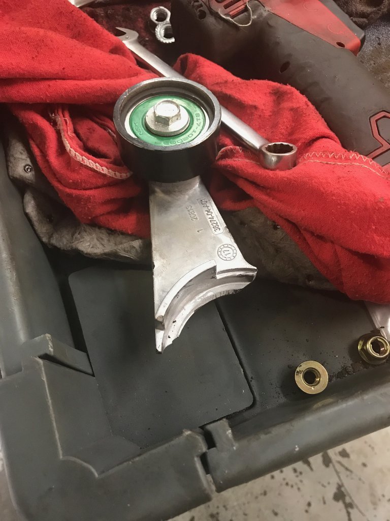

    I'm looking for advice on issues with my 4.0 TRD Supercharger. S/C was installed at 16K by dealer and now has 92K.
    The truck went in to Toyota dealer for a new S/C belt in May (first time I've ever had it replaced.) All was well for 2 mos. and 2K miles.
    Then, my wife was driving home and started hearing squeaking and what sounded like bells ringing under the hood, she said. When I opened the hood, found the S/C belt shredded.
    Flat bed ride to the dealer. Diagnosis: One of the tensioner bolts snapped and broke a pulley. They ended up replacing quite a few parts for the belt system (don't have the invoice in front of me) at the tune of about $1,600 parts and labor. No cost to me, dealer covered, including tow. Got all new coolant too.
    It took a month to get all the parts in from Magnuson in CA. Dealer gave me a new 2017 TRD OR 4x4 DCLB and put about 2,000 miles on it - nice test drive for when I get a 2018 this fall!

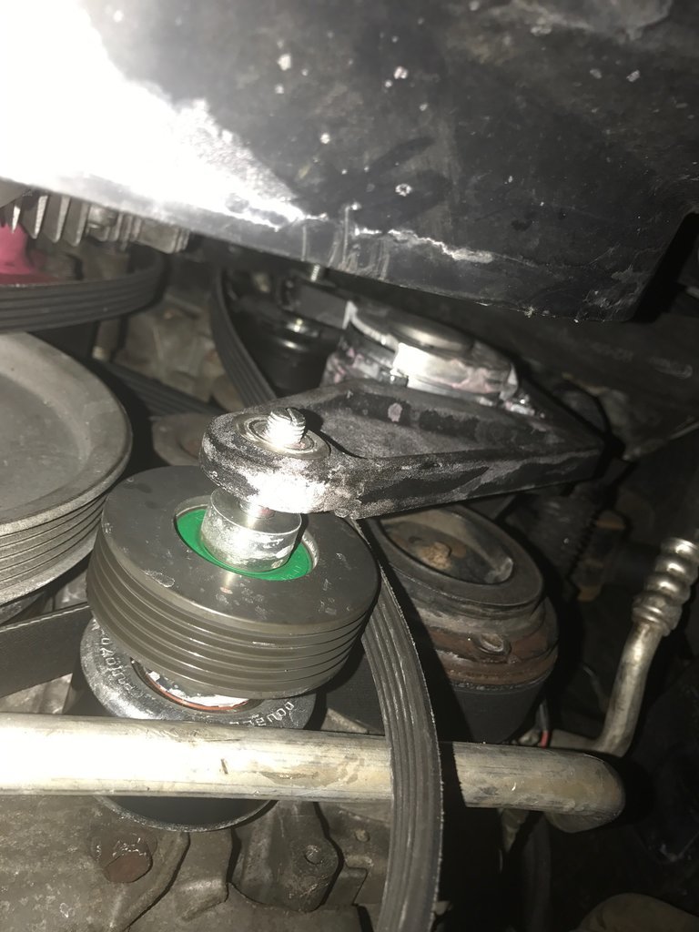

    Get my truck back, in less than a week and 400 miles later, I'm driving along and hear a metal clanging, like something fell off, then lost boost. Pull over, check under hood. Belt is off again. Here we go again.
    Call dealer, another flat bed trip. Lots of apologies from dealer. I want my truck fixed right.
    Here is what they find:
    You can see in this picture where it broke off:

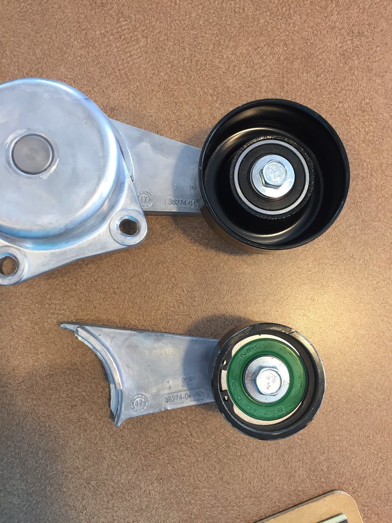

    They call Magnuson, order a new part 38274-04-A01. It arrives today. Part numbers match on new and broken. Dealer calls Magnuson and says these parts are different sizes (broken below compared to new):
    Magnuson says "we were given old inventory with the tensioner that broke, sorry"
    Really?
    I'm looking for feedback here. Based on what you just read and saw, does this new piece look correct? Did the dealer just not install it correctly before? Do they not look the same because that whole outer diameter potentially broke off? Any and all advice appreciated from the Supercharger experts please and thank you!

    I'm looking for feedback here. Based on what you just read and saw, does this new piece look correct? Did the dealer just not install it correctly before? Do they not look the same because that whole outer diameter potentially broke off? Any and all advice appreciated from the Supercharger experts please and thank you![/QUOTE]
    Looks right to me. Seems like something else is off though for you to have these problems. Potential bearing issue perhaps? Maybe its not spinning as freely as it should.

    Dealer called back. They put the "old" new pulley (green in pic) on the new tensioner and it seems to be working well, multiple test drives by them. The black pulley would not fit. So, I'm picking it up tomorrow. We'll see how things go....

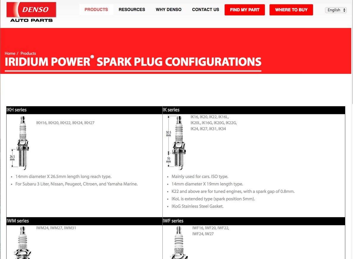

    There is no IK18 (as far as Denso plugs go) so IK16 --> IK22 is only 2 steps colder

    Just the IK's, the IKH's are another Denso category of plugs...I'm going off of this screenshot from their site:
