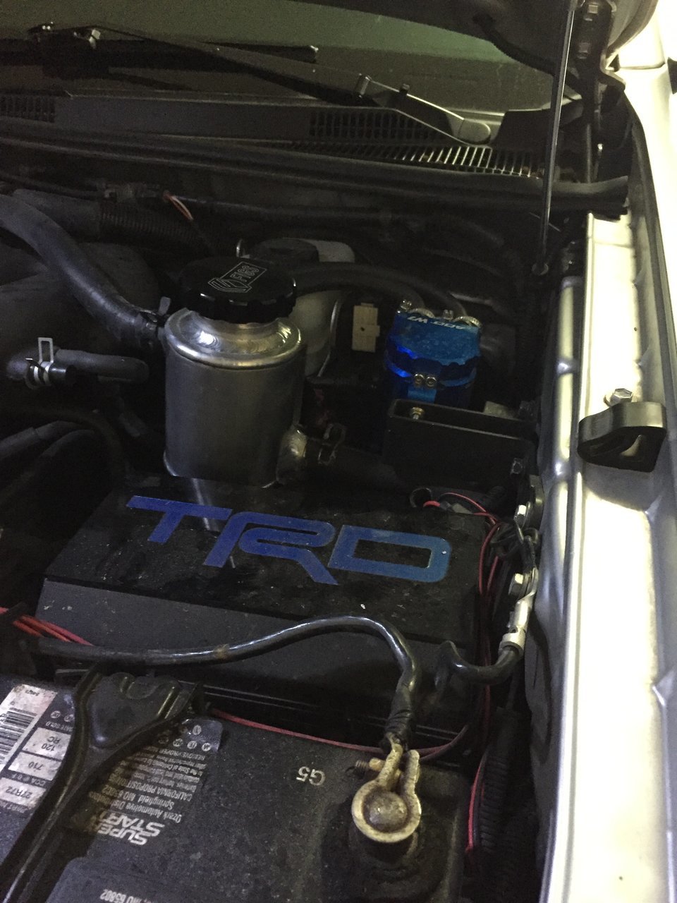

    Also, what is the blue box you got on the side of your coolant reservoir?

    Pretty sure thats an oil catch can.
