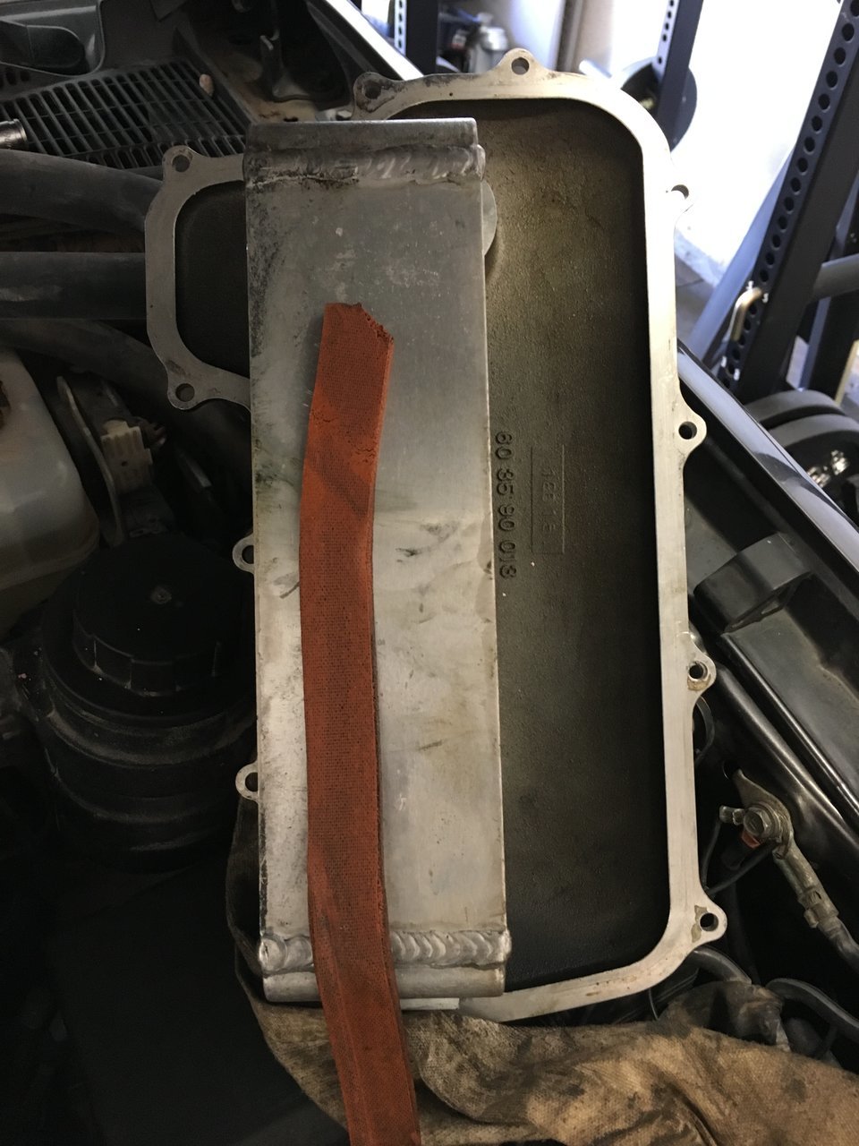

    Very common problem... I’ve been running my blower without that foam strip for years. I think it runs better without

    Say what?! Seriously? Lol. That would be an unmetered vacuum leak though!

    Scratch that. I see what that strip is used for now and where exactly it is placed. I agree, it should just be removed. It could be a problem down the road if it becomes dislodged anyways. I sort of feel like pulling apart my heat exchanger core and removing that stuff now myself.

    I think the only thing the foam strip is used for is directing the air through the intercooler. So the winter months are great. It also soaks up all the oil from the pcv valve. Yes a catch can will get most of that oil but there is always a residue on the intercooler too. I clean my intercooler with carb cleaner couple times a year.

    Lower boost than what I should had been making inconsistent boost, lower vacuum idle and at hard feel. I was making 7-8.5 rarely 10 now I am making my 10 that I should be almost every time. The symptoms were similar to that of the serpentine belt slipping. Peaking at 11. Violent boost engagement at 3k rpm, it's much less now. That little jet throttles the bypass valve instead of allowing it free engagement. Now that it is not restricted all of those odd symptoms went away.
