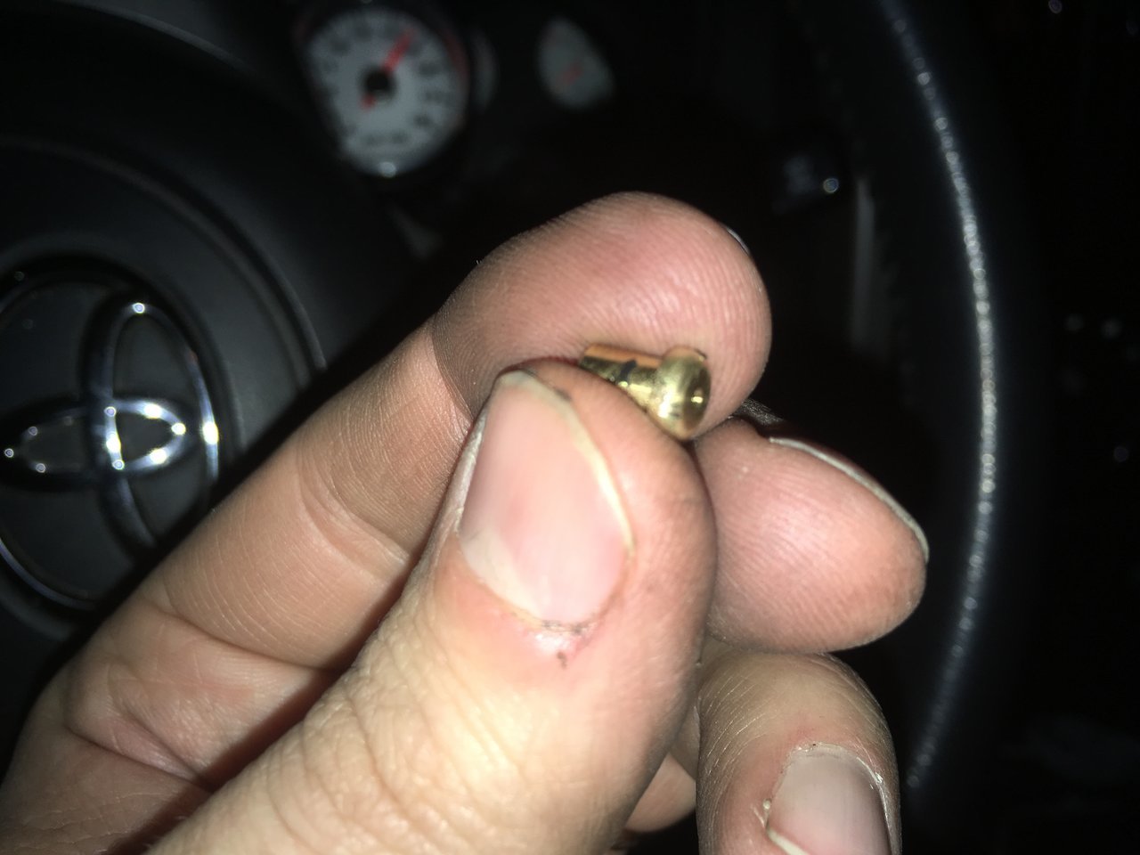

    Lower boost than what I should had been making inconsistent boost, lower vacuum idle and at hard feel. I was making 7-8.5 rarely 10 now I am making my 10 that I should be almost every time. The symptoms were similar to that of the serpentine belt slipping. Peaking at 11. Violent boost engagement at 3k rpm, it's much less now. That little jet throttles the bypass valve instead of allowing it free engagement. Now that it is not restricted all of those odd symptoms went away.

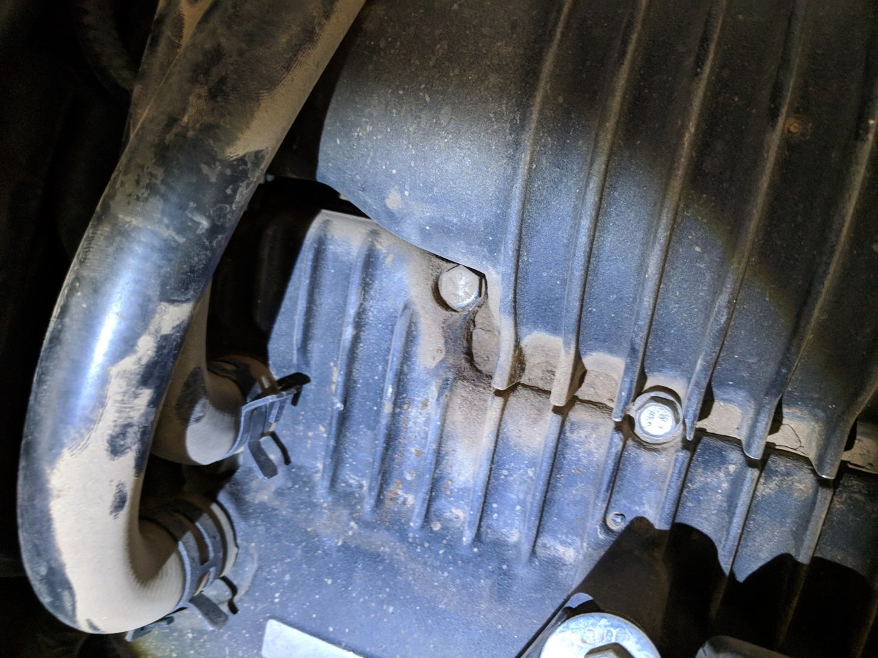

    Checked mine now.. hose is tight on both ends.. takes a good amount of force to pull them off. may clamp them regardless tho.
    Gonna pull the jet out now.
    Also noticed a bit of oil accumulating around the main seal. Might have another vacuum leak there. Fixed it a while ago.. but it's seen better days.

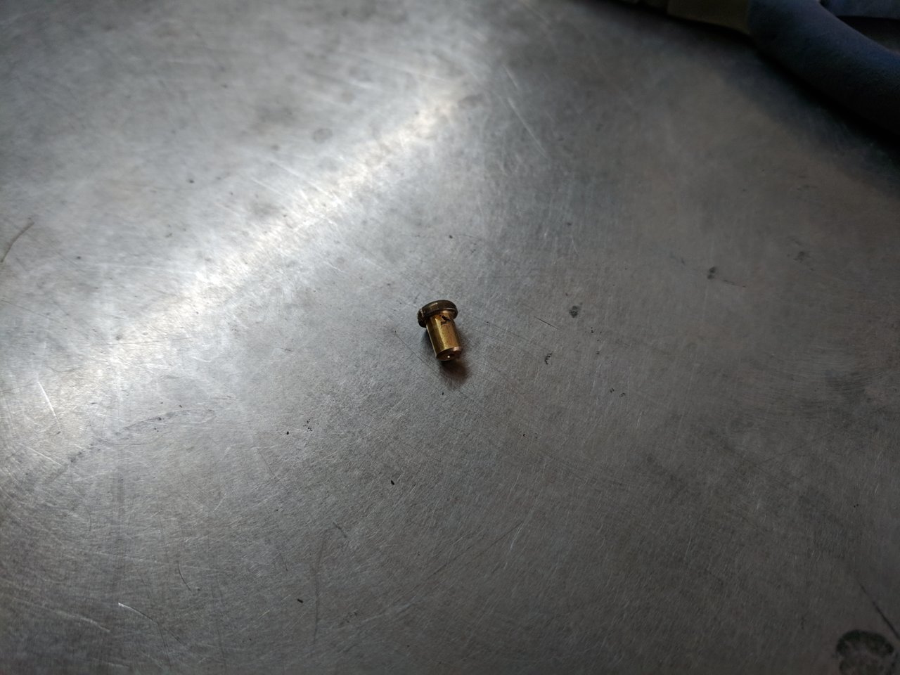

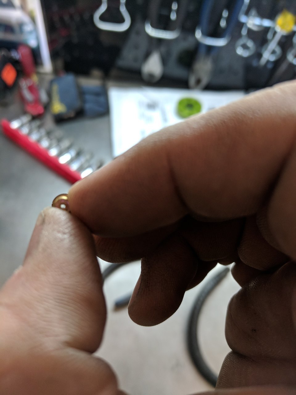

    Got it.. and ziptied the blower side of the hose.. Now for a test drive. Soooo hopeful right now...

    @Torspd @12TRDTacoma Welp.. it did seem to help some. Boost IS more consistent and comes on earlier now (awesome). BUT.. wondering how much of that is weather.. Weather was clear and 72. Was reading a constant 6 and flashing and partially staying at 7 sometimes. Best it's been in a while.
    Wondering if I should test the bypass valve itself now. Disconnect it from the blower side right? Wasn't there something else.
    Also going to pull the snorkel and test with mote airflow.

    Just disconnect and cap off the port.
    Zip tie the hose ends when back together. Just for extra security.
    You'll likely be at 8 without the snorkel. :eek:
    If you are noticing a change, it worked.

    Do not yank it, twist and turn it to loosen whatever slight bond it may have to the port and it will free itself. Mine was not easy to remove either, twisting avoids breaking the port itself, as it is made of plastic.

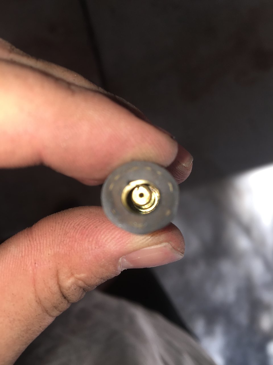

    Let me be more clear,
    I did twist and turn it (hose), it would not even budge, then twisting and pulling harder
    I couldnt get the damn hose off no matter how hard I tried
    Then went as hard as possible and the hose came off with the jet stuck inside it.
    Just test drove and it feels better, not faster but better.
