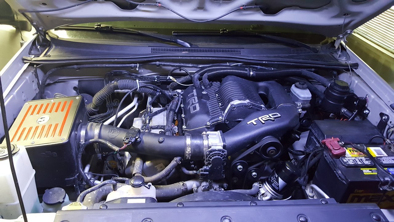

    looks like u have something tied in already
    12TRDTacoma likes this.
  3. Nov 6, 2017 at 12:18 PM
    #4543
    GT7
    GT7 One piece at a time
    Aug 15, 2014
    #136201
    2,502
    Grant
    Phoenix
    2013 DCLB
    Yeah I use that for my boost gauge, is that incorrect?
  4. Nov 6, 2017 at 12:19 PM
    #4544
    inwood customs
    inwood customs Roaming potato
    Sep 11, 2016
    #197024
    4,719
    Dave
    2006 v6 potato bugTuRD
    K&n, flowmaster, plastidip, chipped, hids, daves
    Thats the correct line for boost gauge, and what is used to boost reference. Find a "T"
  5. Nov 6, 2017 at 12:21 PM
    #4545
    GT7
    Aug 15, 2014
    #136201
    2,502
    Grant
    Phoenix
    2013 DCLB
    A T as in so I can route two lines?

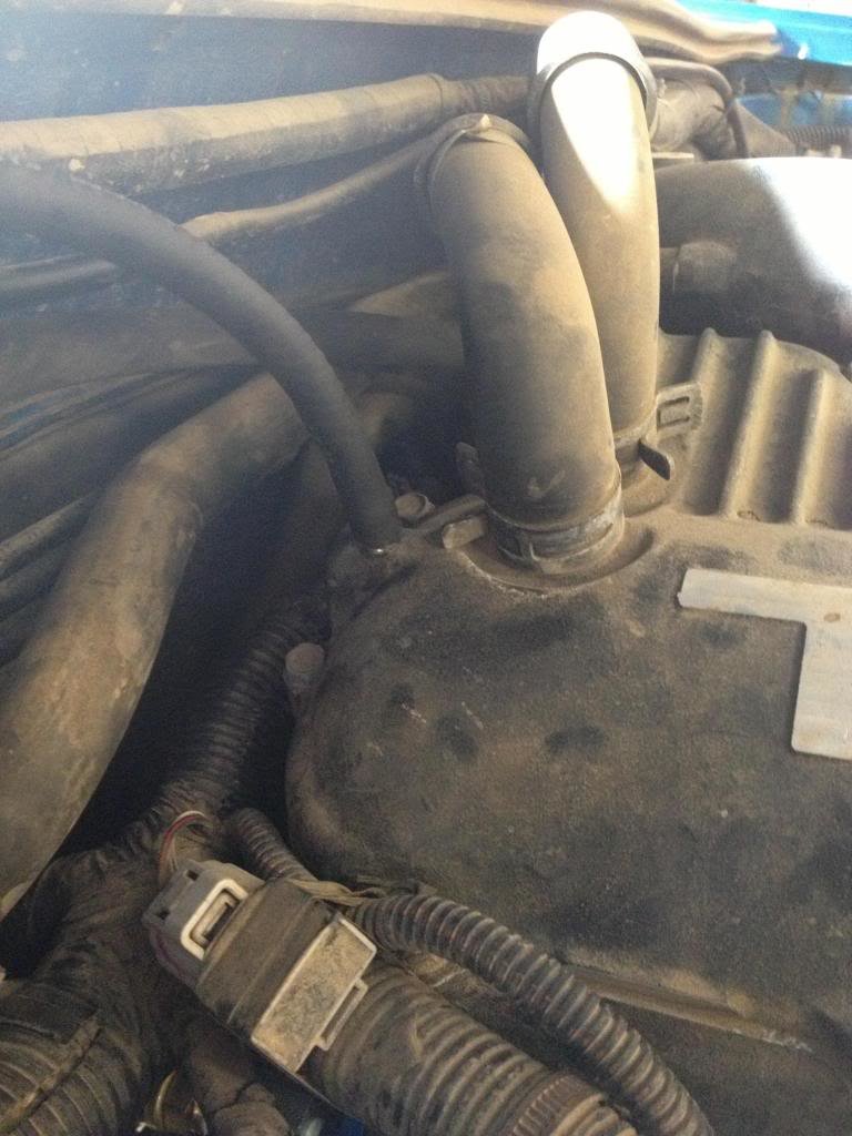

    Yes, and throw a cap on the 3rd prong... same as your intake barb.
    Napa/kragen will have a set of different size caps.20160608_184458.jpg

    Shit, good catch.....
    My phones slow as hell, i didnt notice this.
    The fpr mod isnt done in this pic!
    I just leave the T in place and cap it so whenever i wanna experiment, it only takes a second.
    Take the hose off your intake, cap that barb!
    Sorry about that.

    Run a T. One vacuum line comes from your boost gauge to one end of the T. Hook it up. The other runs from the fuel pressure regulator to another end of the T. Hook that up. Another end of hosing runs from the T to the supercharger boost port hook those up.
    Cap the port at the intake to seal off an unwanted unmetered leak after the MAF. Done. You are now boost referenced and you are also able to monitor boost pressure and vacuum at the same time.
