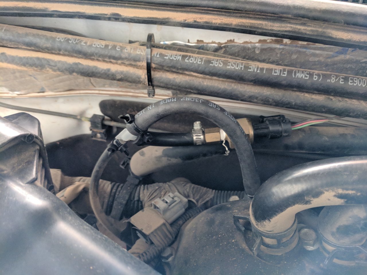

    Don't mind the zipties. Forgot hoseclamps at AutoZone.

    So, when did zip ties become a good clamp?

    I said I forgot hoseclamps.. I only had enough to do a couple. Need a few more. Running back in a bit

    Hose clamps?
    Shit the oem cover barely sits on the boost port with zero issues.
    Ive never run a single hose clamp to any of the parts doing the fpr mod. Its a plastic barb.
    Is this a real concern if the hose fits snug?

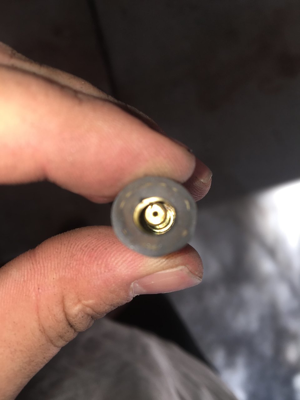

    Did you take the plug out with the actuator on the truck?

    I did. Just grabbed it with needle nose and finessed it out.

    The brass one? Yes earlier and independent of this mod
    Temps were ~88 degrees and gave me a little teeny bit of boost, but got rid of the power surge thing when you really stomp on it, similar to turbo lag
