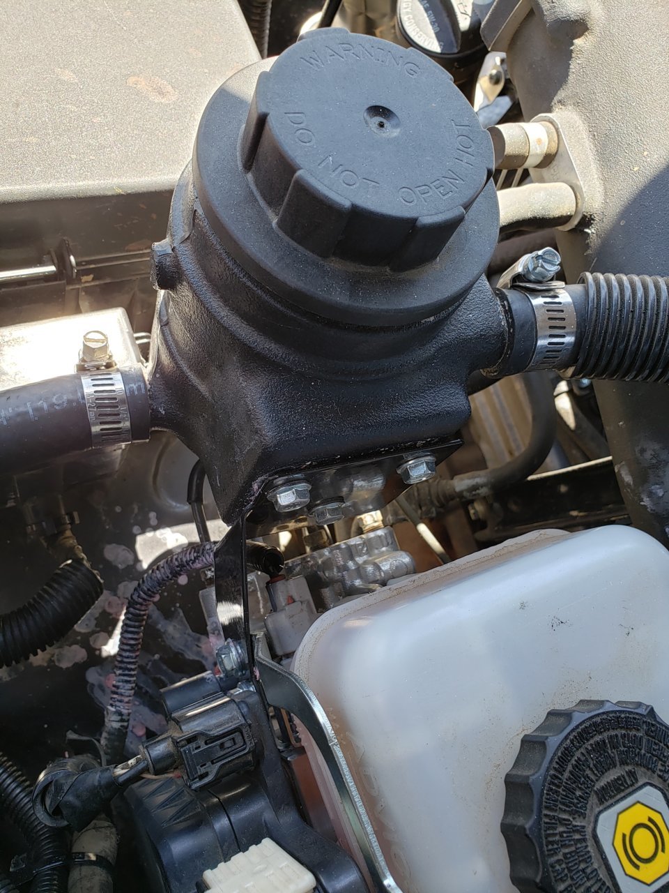

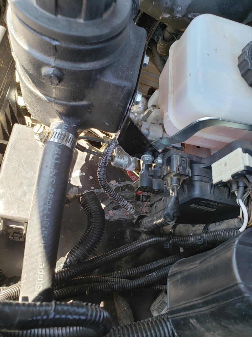

    Any of you having problems with coolant leak? Any recommendation for a link where I can by better clams?

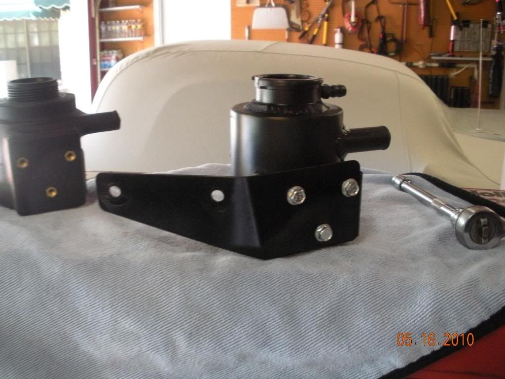

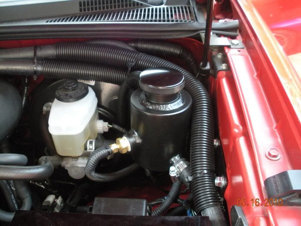

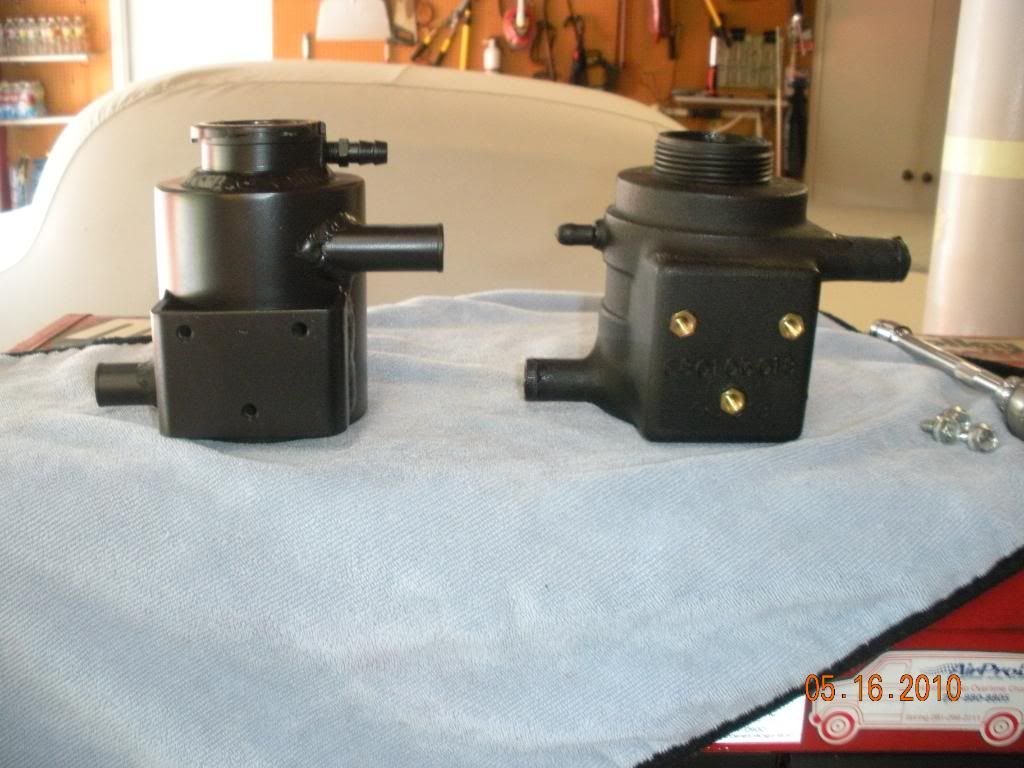

    It is not uncommon for those bottle to split along the seams.
    If that is your problem, I have a spare bottle.

    If you haven’t tried it yet, try and tighten up the clamps. Mine leaked a little and I thought I had big problems. Ended up just being a loose clamp.

    Doesn't leak. Looks good. Problem solved. You already have $5k in the SC.
    Or you could buy a replacement one and wait for it to leak again.

    I'm still trouble shooting, I will let you know if I need the bottle. Maybe I can get one in warranty if need be.

    As a temporary fix I used some plumbers tape under the clamps and it greatly reduced the leak due to metric/SAE hoses. Very small drips now but not e Pugh to cause impactful volume loss. Longer term need to get a different tank.
