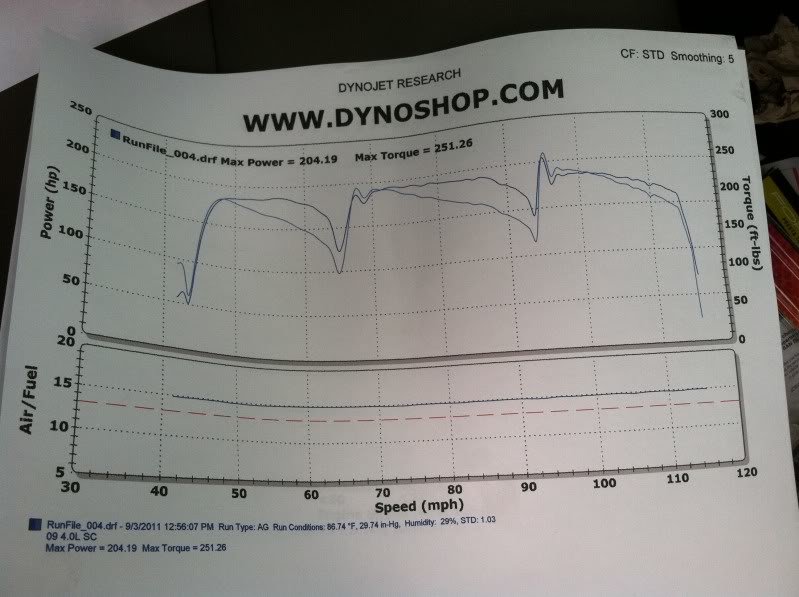

    supercharger,flowmaster 40, trd cai... pretty much about it...a snorkel??? dont know if that would affect it

    wow those numbers are way to low for a s/c. You should be around 280ish.

    280 off the engine or to the wheel?

    did you get the ECU changed/updated for the added S/C

    Yeah I believe so, Toyota should have reflashed it for me, let me look at my receipt again

    Dyno-Jets are not a good high quality dyno. It uses a weighted drum (inertia) which the wheels spin to calculate the torque from there all the information is extrapolated so it's not very accurate. Dyno-Dynamics (loaded dyno) which uses a braking system to get more accurate readings,
    I suggest finding a different dyno shop with a Dyno Dynamics or Mustang Dyno Setup.

    would a different dyno really show a 80hp difference? i mean i feel the difference...but that doesnt mean anything...

    Yes it will. My dad ran a car on Dyno-Jet and was 110hp down on the Dyno-Jet, and realistically you can feel 100hp, like especially in a light car and a truck. Went to a shop who ran a Dyno Dynamics 4-Wheel Dyno and the results came out accurate (Should be approx 80-85% of the bhp). It's worth a shot before digging into more problems.
    Here's a good article to explain about Dyno's: WARNING, it's long :p
