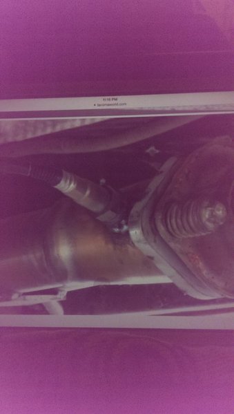

    Hey, I also forgot to ask about the cable that goes from the gauge to the sensor......did you route that though the same big rubber boot where the main clump of wires goes through? Just wanna know if the plug that ends up hooking in to the back of the gauge will fit through there.

    Here's that pic.....I guess it shows what we both meant...

    That looks good. There is enough clearance to not push the cable and cause wear.

    Copy that.....I'm hearing that this afr AEM UEGO gauge has plenty of sensor cable allowing me to run it collector of the y-pipe....like in my above pic. I just want to make sure before I place my order.

    It does. Im right past the passenger side collector and it still has a couple feet zip tied up
