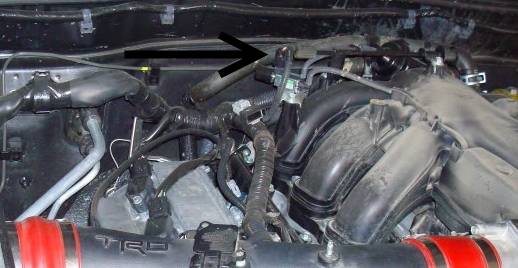

    I installed an SC over the weekend and there was one plug that was plugged in to a vacuum port near the back of the intake plutonium. I did a search and it appears that is no longer used?
    Pic was borrowed from another member.

    Correct, that plug is no longer used with the S/C. It is only for rhe ACIS system on the OEM intake manifold.

    Since I installed the supercharger the VSC light and check engine light have come on a couple times. I disconnected the battery and reset the ECU but they eventually come back. It happened once with the OEM intake and once with the TRD CAI.
    I am lifted 2.5" but have never had the lights come on before.
    Unfortunately, California doesn't allow the rental of the OBD 2 scanner.
    Anyone have any input before I buy a scanner?

    Borrowed an OBD2 and pulled these code:
    P0171 System too Lean (Bank 1)
    P0174 System too Lean (Bank 2)
    P0441 Evaporative Emission Control System Incorrect Purge Flow
    P0455 Evaporative Emission Control System Leak Detected (gross leak)

    Seems to me the the evap solenoid on the driver's side of the s/c, is hooked up improperly with the vacuum lines. Take some pictures of that side and post them up. It will help.

    Updated edit:
    TORSPD,
    Thank you for advising me where to look. You were right, I mixed up vac lines and didn't plug the correct one.
    Just took it out and punched it, no error codes.
