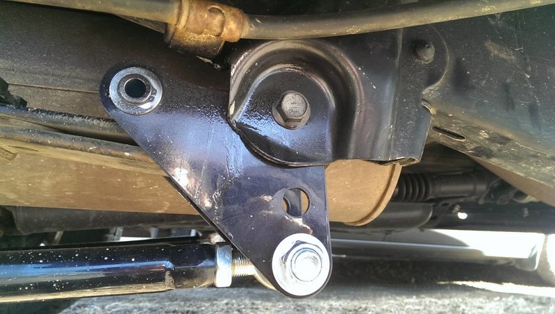

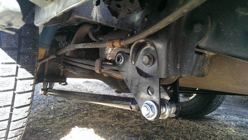

    Well the search for traction bars was from a couple things. Say you were driving around and punched it and the rear end cam lose. Because of the soft springs the axle would wrap a bit then the tires would come loose and then grip again then come loose. Sort of making a "eeeek eeeek eeeek" noise as it gained and lost traction (even in slippery conditions). Putting traction bars on the machine eliminated that completely and firmed up the feeling of the truck when launching. I managed to knock off a little bit of time from my 0-60 with them as well.
    The other thing the traction bars did was get rid of the drive line vibrations that many of us have experienced when accelerating aggressively from 5-25mph.
    2 big benefits, but one drawback. Once they wore in a little bit they rattle on some bumps. Its the cost of going fast.

    Not to spend your money but you gotta try a tacoma with some sort of traction bars. It was well worth the $350 or so. My truck has not bucked once in the two years since i installed them. I think Torspd has the exact same ones I do from Calvert Racing (Caltracs). I dont think its your traction controll because mine would do it with it on or off.

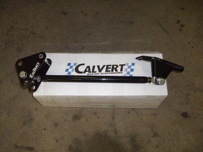

    Look at the video on youtube. (I cant operate this damn ipad) search for thw title "2013 TRD Supercharged Tacoma Acceleration" by Ratcamaro. It will at the end of the video show exaclty what i was expiriencing. And some caltracs are the fix (if you can deal with the occasional rattler, or you can make some silencer busings for it. )
