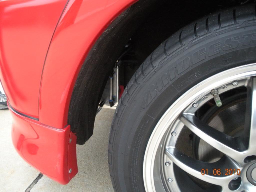

    Anyone try to install an oil drip can after an SC install? I really want to install mine but cant find a way to get my hand in there. The best I've come up with was I went and bought a long pair of needle nose to at least reach in pop the clip off the existing hose, but getting the new hose on might be a bitch lol

    I did it. You will get a few scrapes.

    I mounted mine in an unusual place as compared to most.
    In the fender well on the frame. It is easy to route the hose there. When I change my oil, it is easy to drain.

    Interesting. I'll have to man up and reach in, I guess lol
