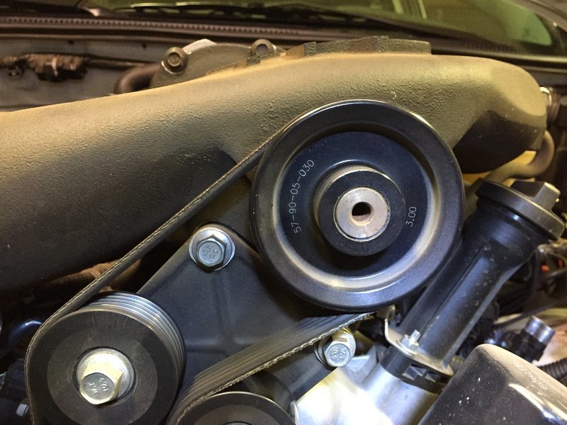

    I believe the dab would be on the center spindle and the center black to be able to tell if it's been switched....I'd go check mine for ya......but it's -12 degrees out right now. I don't have AZ. weather.

    That's the stock pulley

    shit looks identical

    The 90 and the 05 swapped between those 2 pictures. I wonder if that's the tell

    The numbers are different

    Looks the same to me

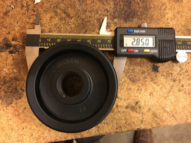

    Damn I didn't realize they looked that exact. Now I'm not sure which pulley I have. I'm starting the think it might be the Urd pulley due to the boost numbers I'm seeing. I really hope not, I just ordered the Urd pulley last night and that's 15 less horsepower I have to gain.
    My calipers are at my shop, but my pulley measured approximately 3.25" outer diameter on the shoulder of the pulley

    Shoulder specs will be the same, its the part the belt rides on that's different. That's why its a 'stealth' pulley. Pull the belt off and measure it there.

    Hey @glorifiedwelder the physical engraving on the stock steel vs the URD pulley is different. If you really want to figure out which pulley you got the answer is simple:
    You can either A. Determine whether the engraving is either stenciled on via the paint (URD), or embossed into the pulley like stock is.
    Or B. (Which is what I would do) just take a magnet to the damn thing. Stock will attract the magnet due to the fact it is made of steel and the URD one will not because it is made of billet aluminum.

    Steel pulley it is. Thanks Roberto

    URD pulley.
