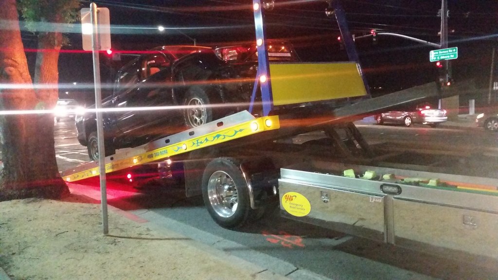

  18. Mar 20, 2016 at 12:33 PM
    #1598
    12TRDTacoma
    12TRDTacoma Powered by Ford, GM, VW, and Mercedes
    Aug 20, 2012
    #85133
    16,671
    Rob
    Concordia
    12 TRD Sport DCLB 4x4 Supercharged
    Boosted
    This is mine, early last year if I remember right. I was NA at the time btw. Like I said. Prepare to pay the price if you don't.
