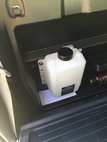

    :thumbsup:I got the same ones but black

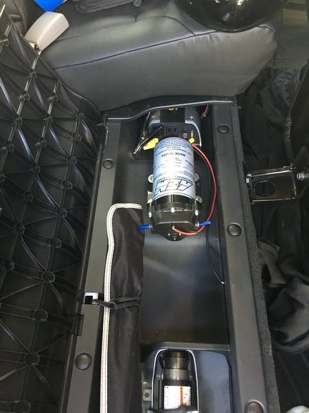

    Billstein 5100s set at 2.5 in the front,2in AAL in the rear with 5100s
    Take and pump mounted

    So you didn't do any cutting. I like it. 2.7 installed?

    2.7, fuel pump and finish the water meth wiring tomorrow

    Nice. I'm jealous.
    Are you running long tubes? Cat less?

    URD headers and ypipe

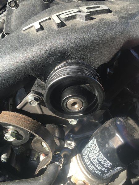

    Well got the 2.7 pulley on. Not the difference I thought it would be. I was expecting about the same feel as going from stock to the 2.85pulley. I'm see about 8.5psi right now. I can feel a difference on the bottom end power.
    Now time to do the fuel pump.

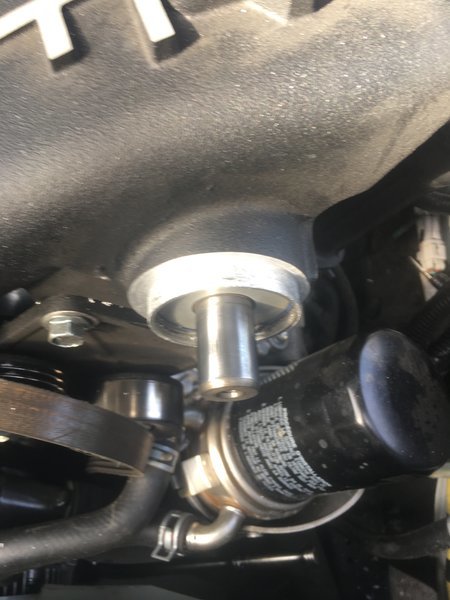

    Do you have to shave the snout for the 2.7? or is that just the 2.55?

    2.7 and 2.55

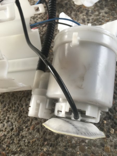

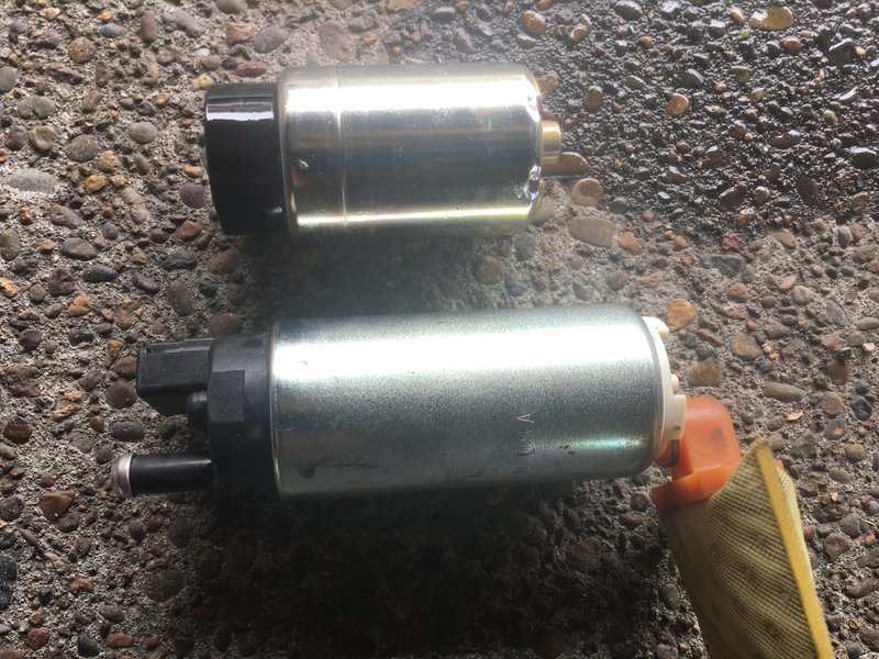

    Factory pump vs 255. Not even going to come close to working.

    to much mod to make it work.
